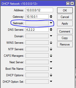

I think the mistake was I started up with Winbox, and reading the Wiki where examples is done with terminal.
In winbox you see more settings than you need to care about, so I cared about it to much :laughing:
An example:
ip dhcp-server network add address=10.0.0.0/12 gateway=10.10.0.1 dns=4.2.2.2
Should be enough to get going, lets see that in Winbox - that netmask box is screaming "FILL ME SEYMOUR FILL ME ALL NIGHT LONG :smiley: :
