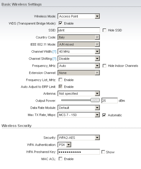

AP Ubiquiti with WPA2 AES, WDS, airMax off, Mikrotik CPE connected to the AP

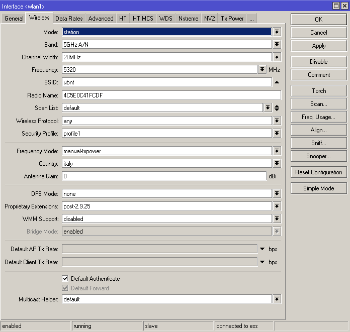

I’ve attached two screenshots.
You can change the Wireless protocol on the Mikrotik CPE from ‘any’ to ‘802.11’. This will shorten connect/reconnect times.
also change channel width from 40 to 20 on ubnt
set mode to station-wds on mikrotik and disable WDS on mikrotik…
