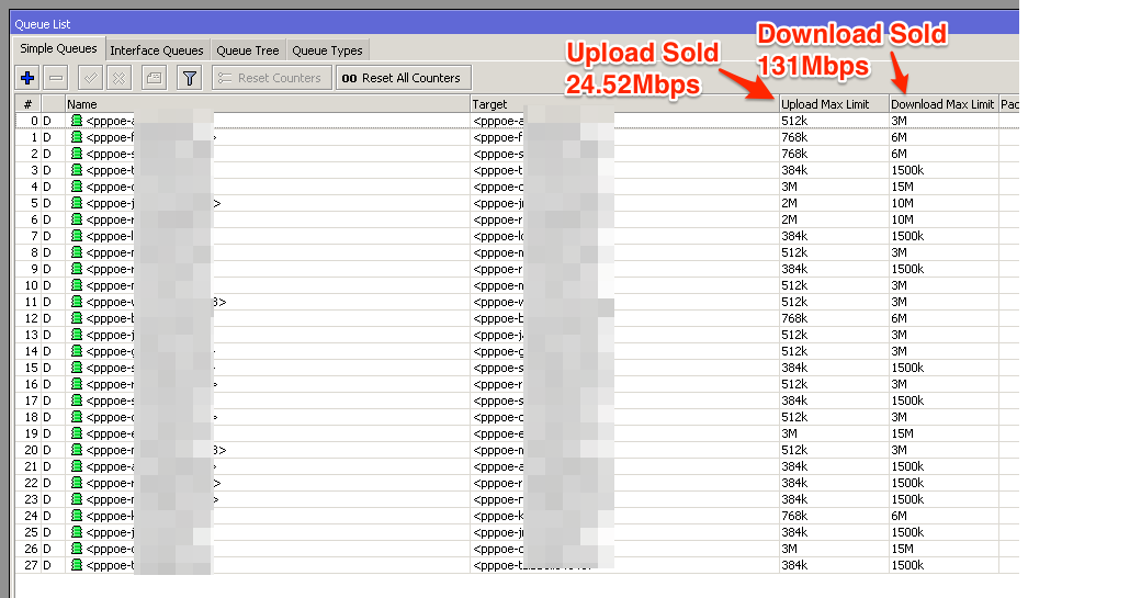

The network that I am getting my 12x from has two feeds of 250Mbps with an average peek load of about 60% to 80% per pipe and about 3500 customers. The most popular bandwidth package is 1.5Mbps although they range up to 20Mbps so I would assume the average is something like 2.5Mbps… This would be roughly 8750Mbps sold… that number divided by the bandwidth purchased is about 17.5x. At a size of 3500 customers I am sure we can exceed 20x.

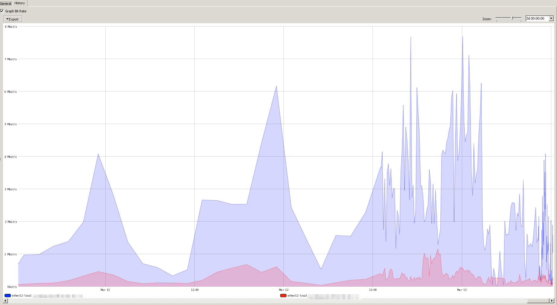

Attached is a listing of a tower showing the bandwidth speeds provisioned and a three day usage graph covering these customers… Make your own judgements about bandwidth overselling. As you can see 131Mbps has been provisioned on this tower… if the 12x multiplier is correct then we would need to budget about 11Mbps to fulfill this. In fact the graphs show even less then 11Mbps of peek usage. Also to be clear, this tower is able to receive over 100Mbps of internet the customers are just not demanding more. I can show you these same trends just about anywhere in our 3500 customer base. The more customers you average speeds over the more you can budget… its like filling a cup with rocks and sand. Most internet traffic is busty (even streamed videos) so one person pulls a lot then the the other and it all works out to about 1/12 according to the statistics I have run.
Also note that the graphs are averaged usage at check-in intervals. I am sure that the interface has exceeded 20Mbps for short bursts but the sustained throughput is closer to a 16x multiplier.
