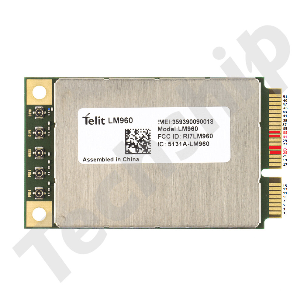

Hello, I am testing a telit lm960 card with a LHG-LTE-KIT-US but mikrotik does not recognize the lm960, someone knows if it is compatible
try to usb 3.0 pins isolated (PINS:23,25,27,31,33)
i want to buy it so let me know if thats work
I know about 2 things to check:
- USB2 vs USB3 mode.
- Routerboard booting delay.
From “techship.com”:
" When the host system and module are powered on, the cellular module will try to probe if USB3 interface is present on the pin lanes and if communication can be established, otherwise the module will revert to using the USB2 data interface instead.
However, in some host systems where PCIe data interface also is implemented on the shared pin lanes, the signals will interfere with the cellular modules probing for USB3 interface making it not fall back to USB2 data interface. This usually result in the cellular module not being detected at all in the host operating system.
The USB3 auto-sensing functionality is enabled by default but can be disabled by using AT commands to write the memory changes to the internal NV memory which is stored between restarts. After the module is restarted it will use only the USB2 pin lanes for data interface. Please also check and validate if the host system BIOS support disabling of the PCIe interface in the miniPCIe socket.
Related AT commands for configuring USB3/USB2 modes:
Telit LM940/LM960 modules:
AT#USBSWITCH=1
AT#REBOOT
2. Routerbord detects PCIe card when booting. If PCIe card internal checks takes longer that RB is waiting for it, card will not be detected. Change default 2s boot delay in System->RouterBoard->Settings.
Note the update 6.45.7, it disables support for this card, but Mikrotik promised to improve it in the next version.
LM960 works In 6.46. At least it’s detected. In RB912.
But it’s not plug and play
Had to:
- change USB to PCIe (system->routerboard->USB)
- disable: system->Ports->firmware->Ignore direct IP mode) when enabled only works as PPP client
- isolate 4 pins
- then it’s detected as USB device
- went into serial terminal: /system serial-terminal usb1 channel=6 (internet says channel=3. I tried all values and found 6 working for me)
- with command AT#USBSWITCH=1, AT#REBOOT to change to USB=2.0 mode
- remove isolation
- start again, but still not visible as LTE interface
- again in serial-terminal AT#USBCFG=3 to " expose CDC-ECM network interface" ← thx to MT support
Since then I can see LTE interface. Time to try to use it.
marcin
