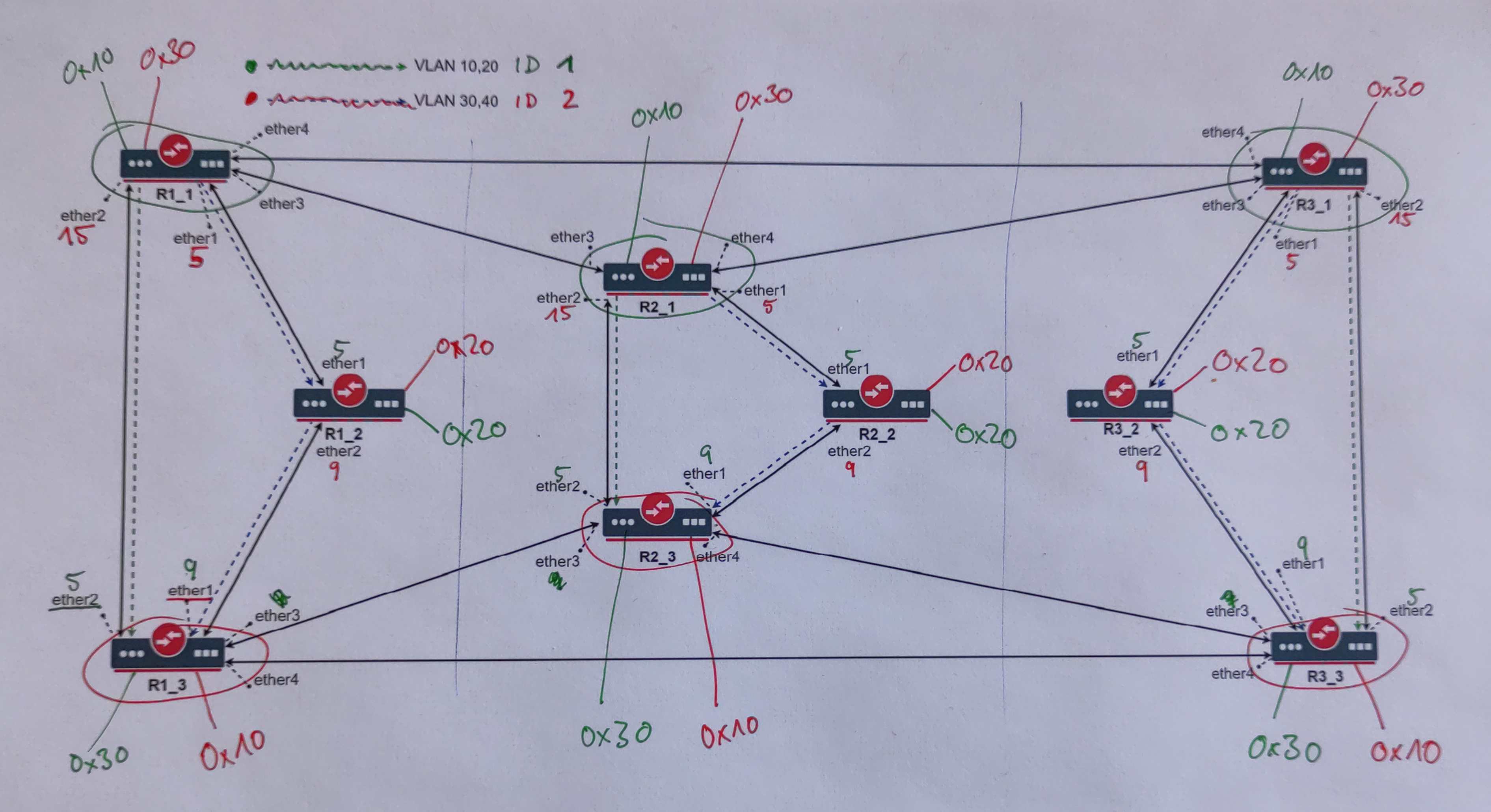

before configuring a MSTP setup, I wanted to completely understand the MSTP example given in the Mikrotik Documentation here: https://help.mikrotik.com/docs/display/ROS/Spanning+Tree+Protocol#SpanningTreeProtocol-MSTPexample.
However, I couldn’t go through it without uncertainties: (See below for the diagram I’m learning on.)
mst-override interface ether3
I’m confused by the configuration on R1_3, R2_3, R3_3:
/interface bridge port mst-override
add identifier=1 interface=ether2 internal-path-cost=5
add identifier=1 interface=ether3 internal-path-cost=9
Why is it ether3, and not ether1? ether3 is connected to a different region. I changed it to ether1 in my notes and continued.

In this case for VLAN 10,20 to reach the third device from the first device, it would choose between ether1 and ether2, one port will be blocked and set as an alternate port, ether1 will have path cost as 5+9=14 and ether2 will have path cost as 10, ether2 will be elected as the root port for MSTI1 on the third device.
- “ether1 will have path cost as 5+9=14” - Is this derived from the
mst-override
for
identifier=1
configured on Rx_2 and Rx_3?
2. If so, why will ether2 have path cost as 10 while ether2 on Rx_3 has a non-default configured path cost of 5? In either case, ether2 would be selected as root port, because for both cases path cost of 14 is higher.
