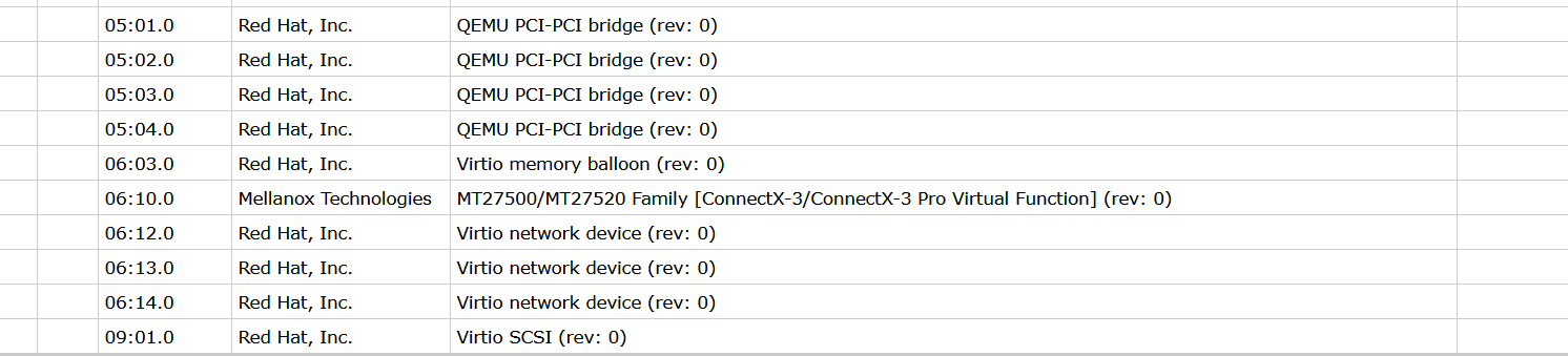

I am newer to SRIOV, but I have some older hardware where I am trying to squeeze out as much performance as possible from the CHR. I have a connect X3 and virtualization the CHR with proxmox.
Under settings > Resources > PCI, I see the connect X3 VF detected, but it does not show up under /interfaces/ethernet.
Is it just simply that CHR does not have the drivers to do PCI pass through/SRIOV for?
SR-IOV is built into the device driver for the network card in your virtual host operating system so you won’t actually see it in CHR. But you might notice that the CPU load and software interrupt rate are significantly reduced at full network throughput when SR-IOV is enabled. If the NIC doesn’t show up, it probably means that the virtual host (Proxmox) isn’t configured correctly.
Ok thanks. I will dig through it more then. When I do the same method with an ubuntu VM for example, I do see the NIC present in the VM. But it passes it along as the Mellanox X3 VF, which was what lead to me wondering if that needs to have drivers within CHR to do so. I will do more research, but it sounds like within the CHR if SRIOV is working, it should show up as a generic network card for a lack of a better term?
The CHR is totaly unaware if the virtual driver uses SR-IOV or not. It just uses the NIC that is provided by the virtual guest where the CHR is located. So if you can’t see the NIC in the virtual guest configuration it won’t either appear in the CHR.
