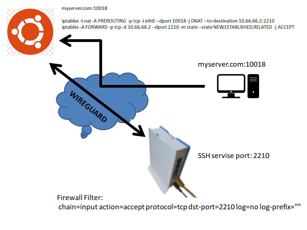

I configured a Hap Lite to work with a wireguard ubuntu server.
The ubuntu server as port forwarding rules to the Mikrotik and Mikrotik get the request and distribute to the devices under its LAN.
All servers under the lan are reachable by port forwarding:
So if you request:
www.myubuntu-server.dom:10152 → you are able to reach the internal server under any connessions.
The point is that the SSH of Mikrotik does not answer the request.
If I add a Firewall filter on Mikrotik I can see the SSH request arriving, but I don’t understand why the SSH connection doesn’t start.
Can someone help me?

This is the network map.
Unfortunatelly hap lite has a bug on export configuration and it doesn’t work.
I want to access SSH to Mikrotik, so I can change or apply changes.
From your question, one presumes that you can SSH into it from the LAN, so instead of exporting the config to a file, say “ssh myrouter /export > localfile.txt”. Now you have a copy of the config in a file on your local machine that you can attach to a post here.
Note that in ROS v7, the old “hide-sensitive” option is now the default, so you don’t need to add that. You must be using ROS v7 if you’re talking about WireGuard, assuming WireGuard is running on the router. If not, you’re off-topic here.
Your diagram adds more confusion than light.
First, why are you showing NAT rules on the Ubuntu box? Surely NAT is the hAP Lite’s job? Are you pressing the Ubuntu box into the role of a NAT router instead?
Second, your arrow doesn’t go through the hAP Lite, but instead directly through the “WireGuard” cloud. Is there indeed a bypass here, or is the diagram wrong?
Third, why are you bothering with port forwarding at all, if you’re also using WireGuard? The point of WG is that you’re connected to the internal LAN from outside, at which point port-forwards aren’t necessary. Surely you just need something like “ssh -p 2210 admin@192.168.88.1”.

The PC is on the internet and make an SSH request to Ubuntu server that have a public IP on the port that will be forwarded to the Microtik
Ubuntu server has a port forwarding to the Microtik Hap lite connected by wireguard.
All works fine with a secondary port forwarding in Mikrotik, so it’s possible to reach the server under the lan of Mikrotic.
In fact I have Rute table/Filter/Mangle and route lookup
So under mikrotik all works perfectly.
the issue is SSH of mikrotic do not answer even I see traffic in:
add chain=input action=accept in-interface=Wg-hap2
My task is to connect in SSH to Mikrotic.
Why doesn’t SSH answer?
Do I need a route lookup too?

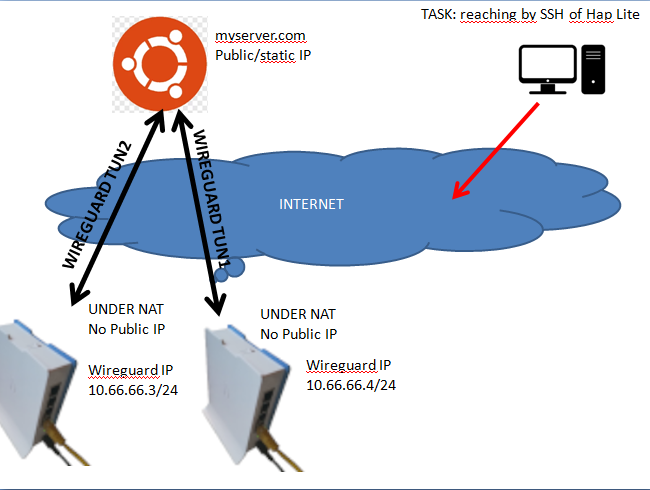

Let’s try to clarify a little better:
FIrst a better network map:
The task is reaching in SSH any mikrotic connected to the main wireguard server.
The request coming from internet go to the main server on a port (for example) 10501
here the NAT will move to the mikrotic device with a FORWARDING iptables:
iptables -t nat -A PREROUTING -p tcp -i eth0 --dport 10501 -j DNAT --to-destination 10.66.66.3:2201
iptables -A FORWARD -p tcp -d 10.66.66.3 --dport 2201 -m state --state NEW,ESTABLISHED,RELATED -j ACCEPT
I put the SSH listeing on the port 2201 of mikrotic but it seems that if the request arrived from the Wireguard tunner SSH doesn’t answer.
I don’t understand why? Beucase I am able to move any request to any sub NAT under the Mikrotik
Hope the question is clear.

That is getting clearer, its me that is lacking in experience of such servers.
What the heck are you connecting to that is in the RED??
What is it? Where is located? Why do you have access to configure it?
Its the missing link? Is it an online CLOUD COmputer you have access too??
Let assume its a cloud computer.
All you need to do is connect to this cloud computer via wireguard, from your laptop,k and you are showing you can connect the two Mikrotik products via wireguard to this red object.
Therefore you have all the tools you need to connect via SSH from your laptop to each MT device.
The other elements are you need some connection initially the the MIKROTIK devices to setup their wireguard settings and firewall permissions and routes.
You need access to the red object to configure WIFI and any firewall rules and routes required.
Have you tried a 2-level SSH from the machine in the upper right corner of your new diagram? Using OpenSSH commands, it’d be:
me@local$ ssh myserver.com
me@myserver$ ssh -p 2201 admin@10.66.66.3
The first command presumes that you have the user name and port set up in ~/.ssh/config for myserver.com. I put them on the second command since you gave them above, but you haven’t for myserver.com, so it’s up to you to manage that detail.
The WG tunnel should have created a route that allows the second command to succeed, and for the reply from first MT box to come back to myserver.com. If so, you’re logged into the first MT box via SSH, as you wanted.
It seems you’re trying to “snap” that double SSH link to present the MT box’s SSH server on a public IP. I’m not in a good position to help you with that. I simply wouldn’t bother with this step. If you had to have it debugged, it’s off-topic here.
From my perspective, the address translations on myserver.com cause needless confusion and fail to add a compelling level of functionality over what you have without them. I can see that it’d be nice to have, but it isn’t essential, so why fight it until you get the simpler case working?
Is that still true with all the myserver.com NAT stuff out of the way and with the “ssh 10.66.66.3” command above?
If that also fails, then you have a case where you’re on-topic with debugging MikroTik’s implementation of WireGuard.
If it succeeds, then as far as I’m concerned, you’ve got a solution, since the two commands above can be collapsed to a single command:
me@local$ ssh -t myserver.com ssh -p 2201 admin@10.66.66.3
That will bounce you through myserver.com to the SSH server on the MT box at WireGuard IP 10.66.66.3.
As for my suggestion to use “ssh -R” above, that requires a copy of OpenSSH on the LAN side with the MT boxes, which you don’t show. If you have such a thing, it allows a direct connection without the “ssh -t” relay trick, but I’m not going to detail it if it doesn’t apply to your situation.
One further thought: what you diagram now looks like a better use case for ZeroTier than WireGuard. WG is point-to-point, but what you’re showing now is a cloud of devices across the Internet that need to behave as if they were all on a single LAN. That’s what ZeroTier does.
I’m not saying you need to get rid of your WG + SSH setup, just that some of your pain is coming from choosing that over ZeroTier.
zerotier is available on less devices which can be problematic.
Including the hAP Lite, I see now.
As I said, though, it isn’t essential to switch from WireGuard. It’d have just been nicer, is all.
Thank you!!!
You are perfectly right.
So, I can SSH to my server and from there to Microtik hAp lite
Tested and it works :slight_smile:
I never thought about this possibility.
But it remains a question… Why I can forward http / https / ftp / RTSP … but the SSH I can’t
what is wrong in my iptables:
iptables -t nat -A PREROUTING -p tcp -i eth0 --dport 10201 -j DNAT --to-destination 10.66.66.3:2201
I was thinking I can forward easily the service so I could make it accessible from outside.
What is wrong with my approach?
