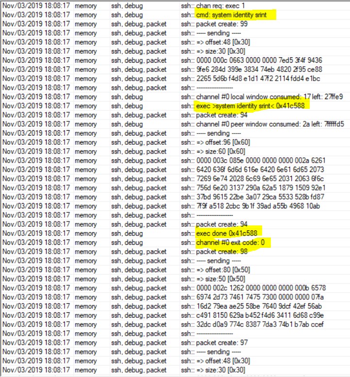

Hi, I am trying to automate deployment of the let’sencrypt certificate from a windows to my Mikrotik router.
I am using posh-ssh module and its invoke-SSHcommand commandlet.
The commands are executed successfully, but the issue I am having is, that the exit-code is always 0, even if I have a typo in the command.
I could find the same exit-code in the debug log on my router, so it looks to me the router is really returning it.
Do I understand the log right?

I’m experiencing the same problem, trying to remotely backup other routeros devices from my routeros router.
The exit-code is always 0, whatever happens during remote script execution, and the output only gives part of the remote commands console output when executed from a local terminal.
