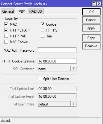

The hotspot was set up using the selection “SSL - None”(attached a screenshot).
If a user connects to the hotspot and is not redirected to the login page(which normally happens on smart phones and tablets), then the user usually types in Google(which is a SSL site) in their browser they get an SSL error instead of the hotspot login page.
Anyway around this?
Regards
I have not found a way around that. The original request prior to login must be unsecured port 80.
