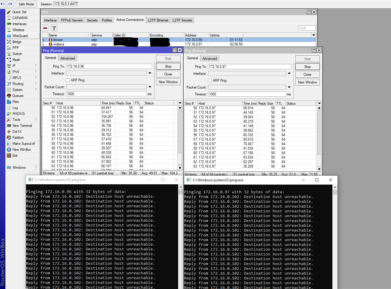

i have R1 which is sstp server
R2 client sstp remote ip 172.16.0.96
R3 client sstp remote ip 172.16.0.97
i want to winbox access R2 with remote ip 172.16.0.96
i want to winbox access R3 with remote ip 172.16.0.97
but couldn’t.
both R2 and R3 reachable in R1 terminal but not reachable on LAN.
hope u understand.
I assume that “not reachable from LAN” means, that you cannot ping R2 or R3 from a workstation connected to R1 and (probably) this workstation shares the same network range with R2 and R3.
If that’s the case, you probably forgot to set the “proxy-arp” on the local LAN interface on R1 - as described in the manual: https://wiki.mikrotik.com/wiki/Manual:Interface/SSTP#Connecting_Remote_Client - so the the connection fails, because IP cannot be translated to destination MAC address as ARP request stays without any response (because those sstp interfaces does not have L2 connectivity to the rest of your LAN).
PS: the new version of documentation does not contain this info> https://help.mikrotik.com/docs/display/ROS/SSTP I wonder why…
You need a NAT rules for traffic from LAN IP’s to the SSTP server’s address (action=masquerdade with 172.16.0.0/24 as src). Otherwise the far-end routers (SSTP clients) will have no idea how to send packet to your LAN (e.g. say your main LAN is 10.10.10.0/24, so unless that was a /ip/route to 172.16.0.1 (SSTP Server).
You might also have firewall filter that’s blocking this is, but the above may the first problem. If you post your config, I’m sure @anav’s firewall eyes will spot the problem.
FWIW proxy-arp may also work too. But I suspect Mikrotik is trying to steer folks to Layer3 routing to solve, vs “arp tricks”.
thanks for your reply
please see my configuration
I have posted

new-packet-mark=Speed_Pkt passthrough=yes
add action=accept chain=prerouting comment=“Farmhouse => Head office”
src-address=192.168.100.0/24
add action=mark-routing chain=prerouting new-routing-mark=
“to_PPPoE Farm house” passthrough=yes src-address=192.168.100.0/24
“to_PPPoE Farm house” passthrough=yes src-address=172.16.0.107
add action=masquerade chain=srcnat comment=“Masquerade Local Network”
src-address=172.16.0.0/16
src-address=192.168.0.0/24
add action=dst-nat chain=dstnat comment=“Port Forward Kamran Arif”
dst-address=203.223.173.67 dst-port=4480 protocol=tcp to-addresses=
172.16.0.102 to-ports=3389
add action=dst-nat chain=dstnat comment=“Port Forward Wavetec” disabled=yes
172.16.0.240 to-ports=3389
add action=dst-nat chain=dstnat comment=“FreePBX SIP NAT” disabled=yes
dst-address=203.223.173.68 dst-port=5060 in-interface=
“ether8_WAN Head office” protocol=tcp to-addresses=172.16.0.66 to-ports=
5060
add action=dst-nat chain=dstnat disabled=yes dst-address=203.223.173.68
dst-port=5060 in-interface=“ether8_WAN Head office” protocol=udp
to-addresses=172.16.0.66 to-ports=5060
dst-port=5061 in-interface=“ether8_WAN Head office” protocol=tcp
to-addresses=172.16.0.66 to-ports=5061
dst-port=5061 in-interface=“ether8_WAN Head office” protocol=udp
dst-port=5090 in-interface=“ether8_WAN Head office” protocol=tcp
to-addresses=172.16.0.66 to-ports=5090
dst-port=5090 in-interface=“ether8_WAN Head office” protocol=udp
dst-port=9000-9500 in-interface=“ether8_WAN Head office” protocol=udp
to-addresses=172.16.0.66 to-ports=9000-9500
dst-port=10000-20000 in-interface=“ether8_WAN Head office” protocol=udp
to-addresses=172.16.0.66 to-ports=10000-20000
add action=dst-nat chain=dstnat comment=“Hair-Pin NAT” disabled=yes
dst-address=203.223.173.68 to-addresses=172.16.0.66
/ip firewall raw
add action=drop chain=prerouting comment=“Block Windows update” content=
autodesk.com disabled=yes
update.microsoft.com disabled=yes
add action=drop chain=prerouting content=download.microsoft.com disabled=yes
add action=drop chain=prerouting content=.windowsupdate.com disabled=yes
add action=drop chain=prerouting content=ntservicepack.microsoft.com
disabled=yes
add action=drop chain=prerouting content=stats.microsoft.com disabled=yes
add action=drop chain=prerouting content=wustat.windows.com disabled=yes
add action=drop chain=prerouting content=windowsupdate.microsoft.com
disabled=yes
add comment=“PTCL Static Route” disabled=no distance=2 dst-address=0.0.0.0/0
gateway=“192.168.210.1%ether7_WAN PTCL” pref-src=”" routing-table=main
scope=30 suppress-hw-offload=no target-scope=10
add comment=“Farmhouse Static Route” disabled=no distance=1 dst-address=
0.0.0.0/0 gateway=“PPPoE_Farm house” pref-src=“” routing-table=
“to_PPPoE Farm house” scope=30 suppress-hw-offload=no target-scope=10
add comment=“PrimeNet Static Route” disabled=no distance=1 dst-address=
0.0.0.0/0 gateway=“203.223.173.65%ether8_WAN Head office” pref-src=“”
routing-table=main scope=30 suppress-hw-offload=no target-scope=10
gateway=“192.168.210.1%ether7_WAN PTCL” pref-src=“” routing-table=
/ip service
set telnet disabled=yes
set ftp disabled=yes
set www port=4478
set ssh disabled=yes
set api disabled=yes
set winbox port=4477
set api-ssl disabled=yes
/ppp secret
add local-address=172.16.0.1 name=ittower profile=default-encryption
remote-address=172.16.0.96 service=sstp
add local-address=172.16.0.1 name=midland profile=default-encryption
remote-address=172.16.0.97 service=sstp
/system clock
set time-zone-name=Asia/Karachi
/system identity
set name=“Central Park”
/system logging
set 2 disabled=yes
/system note
set show-at-login=no
/tool romon
set enabled=yes
