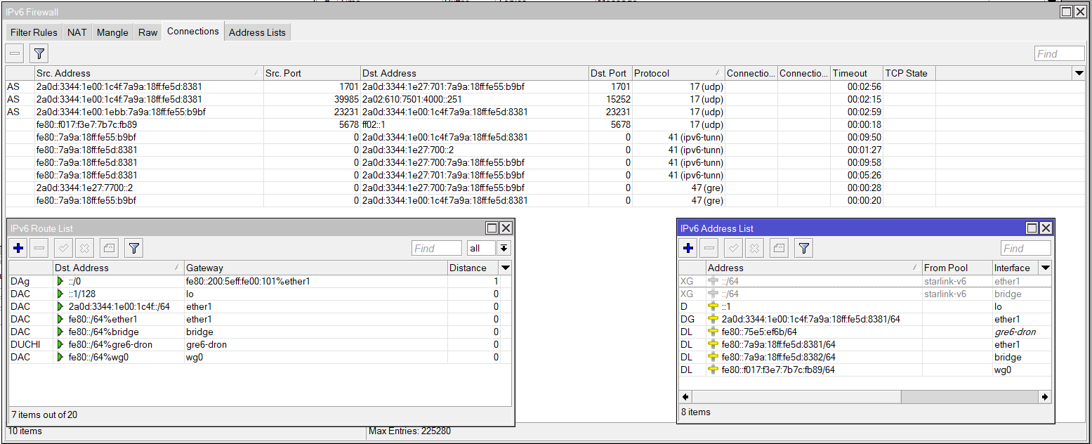

Hi everyone, I have two starlink in bypass mode and two mikrotik hex RouterOS 7.15.1. I use ipv6 to build gre tunnel between mikrotik and tunnel did not work.All ipv6 firewall rules is default, when I look at connections I see that grev6 tunnel use src address fe00 local address but other type vpn tunnel l2tp and wireguard use global address 2a0d and tunnel connect without problems.If I use my Global ipv6 address in Local Address in gre tunnel nothings is changed

This problem only between two starlik, if I make GRE6 tunnel my home router and any of this starlink gre6 tunnel works without any issues.This problem only between two starlik. I do not use /tool/sniffer/ I see all connections in ipv6/firewall/Connections
OK, /ipv6/firewall/connections is not bad, but sniffer shows you whether the packet has left through the correct (expected) ethernet interface at one end and whether the same packet has reached the ethernet interface at the remote end. /ipv6/firewall/connections do not care about interfaces, only addresses, protocols, and ports, and you can only see whether there was any response based on the S (Seen-Reply) attribute.
Something may be wrong with Starlink’s handling of GRE on IPv6, with routing, or with the way how the GRE6 interface is created. Since other types of tunnels over IPv6 apparently work fine between two Starlinks, I deem the first variant most likely, but I still prefer to make conclusions based on evidence, not just assumptions.
