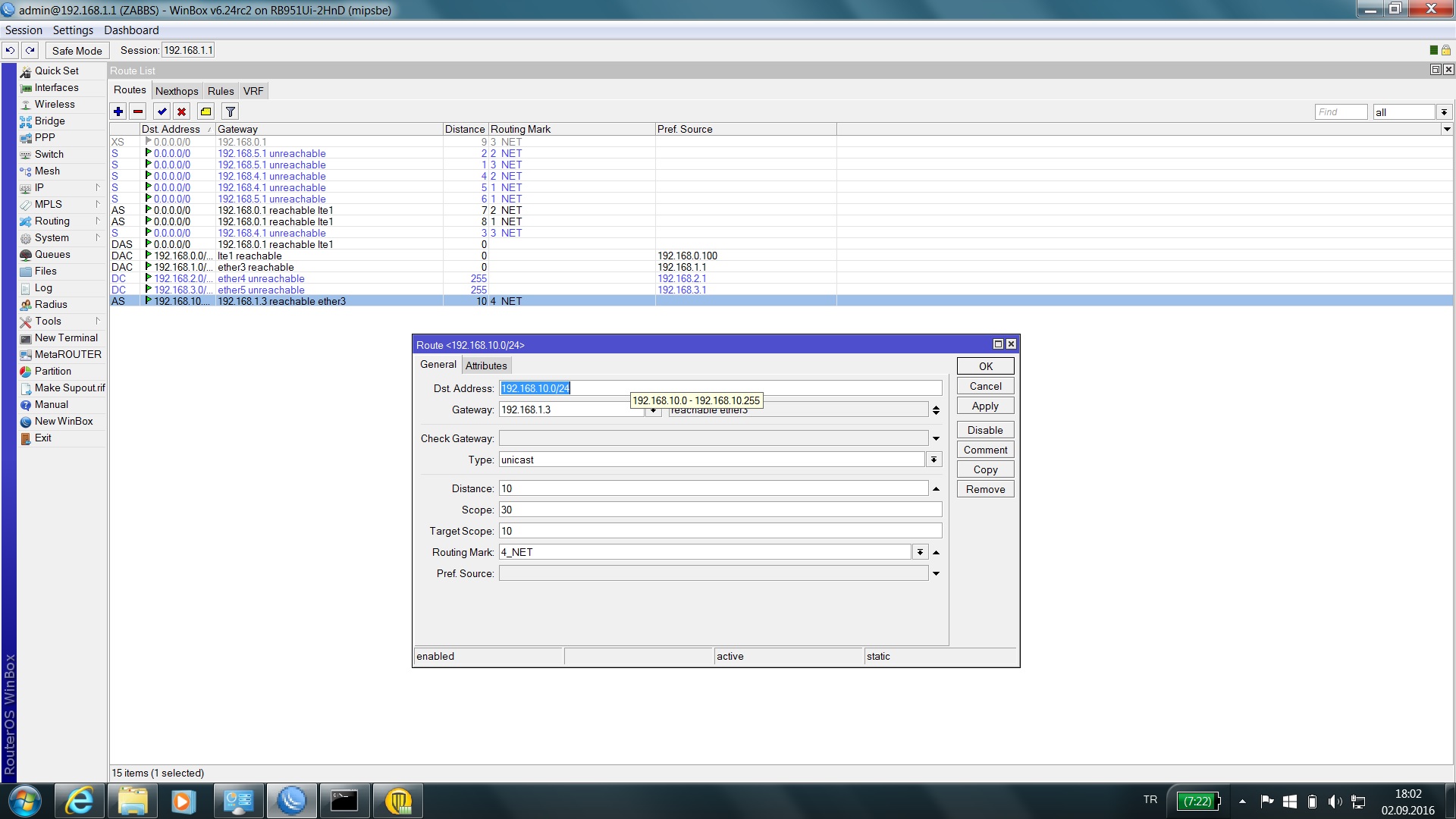

Thanks alot for your detailed explanation.
Actually, I understood more about routing.
I did the necessary amendments (although we did before) and tested the scenario in the respect of Routing Mark rules. However, there is still something wrong.
In order to understand our routing table better, I attached a screenshot.
Please, let me know if you need more details.
Thanks in advance.
BR

    192.169.10.9
add comment="Fiedmic PC" disabled=yes distance=30 dst-address=172.12.2.0/24 \
    gateway=192.169.10.9
add comment="Fiedmic IP Phones" disabled=yes distance=30 dst-address=\
    172.12.5.0/24 gateway=192.169.10.9
add comment="Fiedmic Camera " disabled=yes distance=30 dst-address=\
    172.12.6.0/24 gateway=192.169.10.9
add comment="FIEDMIC Attedence Machine" disabled=yes distance=30 dst-address=\
    172.12.9.0/24 gateway=192.169.10.9
add distance=30 dst-address=172.14.1.0/24 gateway=192.169.10.14
add distance=30 dst-address=172.14.2.0/24 gateway=192.169.10.14
add distance=30 dst-address=172.14.4.0/24 gateway=192.169.10.14
add distance=30 dst-address=172.14.5.0/24 gateway=192.169.10.14
add distance=30 dst-address=172.14.6.0/24 gateway=192.169.10.14
add distance=30 dst-address=172.14.9.0/24 gateway=192.169.10.14
add distance=30 dst-address=172.14.10.0/24 gateway=192.169.10.14
add distance=30 dst-address=172.15.0.0/16 gateway=192.169.10.14
add check-gateway=ping distance=30 dst-address=172.16.0.0/16 gateway=\
    192.166.10.14
add distance=30 dst-address=192.161.10.12/30 gateway="OILMILL Data Link" \
    scope=10
add distance=30 dst-address=192.167.10.8/30 gateway="SERVER ROOM TO FIEDMIC" \
    scope=10
add distance=30 dst-address=192.167.10.12/30 gateway=\
    "Headoffice to Server Room Nexlink" scope=10
add distance=30 dst-address=192.169.10.8/30 gateway=ether10 scope=10
add distance=30 dst-address=192.169.10.12/30 gateway="SERVER ROOM TO HO" \
    scope=10
/ip route rule
add action=lookup-only-in-table dst-address=172.12.0.0/16 table=main
add action=lookup-only-in-table dst-address=172.15.0.0/16 table=main
add action=lookup-only-in-table dst-address=172.16.0.0/16 table=main
/ip service
set telnet disabled=yes
set ftp disabled=yes
set www port=81
set ssh disabled=yes
set api disabled=yes
set winbox port=8219
set api-ssl disabled=yes
/ip traffic-flow
set cache-entries=64k enabled=yes
/system clock
set time-zone-name=Asia/Karachi
/system identity
set name="Server ROOM Internet "
