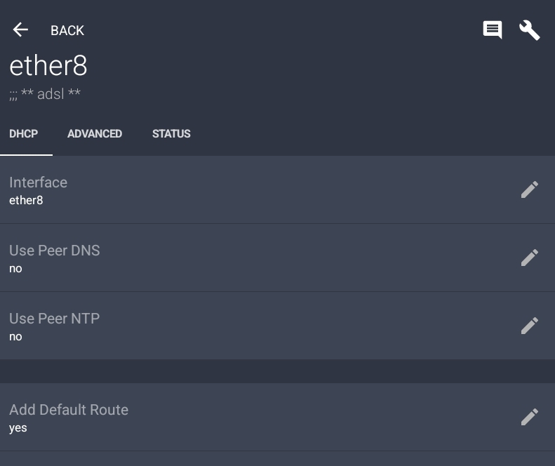

Add DHCP client onto the interface to the LTE router, and select the option to add default route.
Thanks aesmith, I’ve already got that enabled and it does create a dynamic route, but that gateway IP changes with the LTE connection every time it relinks.
The only “constant” is “ether2” but it does not like sending traffic to a port instead of an IP.
