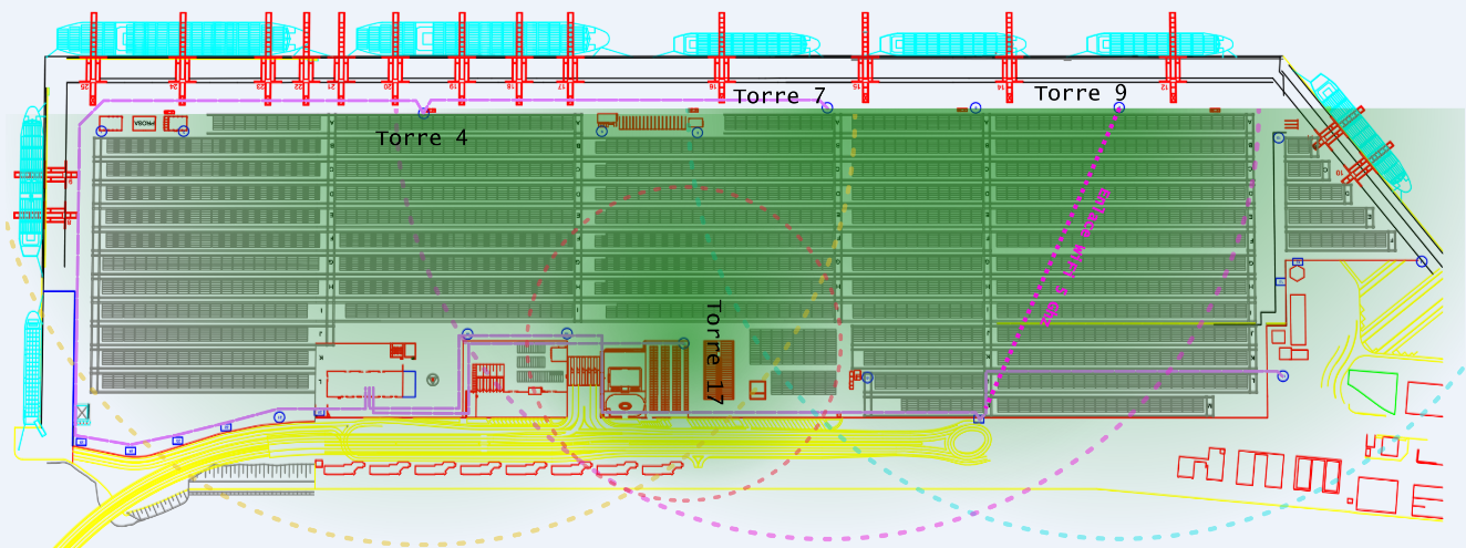

This is my “yard”
The APs are 90º side by side one of the other with 120º sector antennas.
The clients are Mikrotik Groove A on top of RTG cranes moving along the yard over the containers.

From the drawing (good job BTW!!!), are the dotted lines the areas that the APs cover? If so, way too much overlap. People always go on about a good amount of overlap. Some overlap, yes, but not too much. So perhaps lower power output. And also, you have tower 17 in the middle of it all. It could be adjacent-channel interference. That’s always bad.
When in doubt, a good site survey will always be of value. The hardware and software can be expen$ive, but the results will save you a ton of pain. You’ll “see” the coverage from all APs, and get results such as interference from your APs, from other devices you don’t own, etc.
From the values that you get as RSSI (very small delta), I get your point now that maybe the STA should be a bit more “sticky”. But since you cant configure sensitivity right now, perhaps you could try lowering power on one of the APs when the rig is in the middle of the yard, which would give you a bigger RSSI delta and have more predictable roaming.

The dot lines are only for documentation purpose, in reallity the coverage of tower 7 reach all the yard but in order to have a redundancy and divide the total equipments quantity over different APs because we are using 802.11 an not any TDMA protocol.
The total quantity of equipments is over 130 clients.
I am glad that i manage to explain the issue, now the job is to have Mikrotik involved and make this little change to RouterOS in order to improve the roaming capabilities, that nowadays are fantastic.
About tower 17, this tower in reallity is not needed but in the same tower, there is a Vodafone link and the noise near the tower is incredibly high in all the 5 Ghz and 2 Ghz band, because that, i installed a AP in the tower to cover the noise area.
