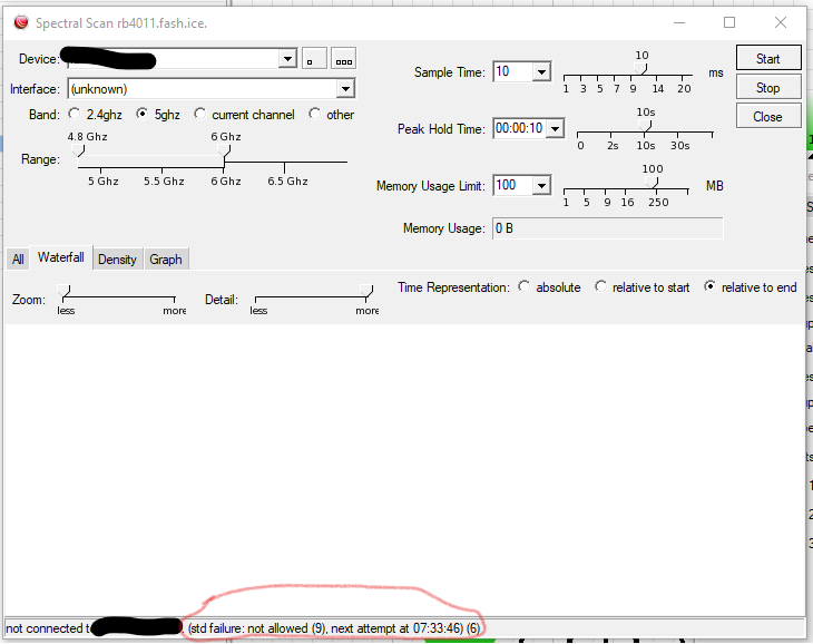

I've got some weird issues using wifi, so I wanted to use the Dude (spectral scan) to look into this problem.
But when trying to do so I get a std failure.
I've looked at the posts mentioned below, any suggestions what to do?
With regards,
Screenshots of the router settings and the dude
std failure post, with read group being metioned

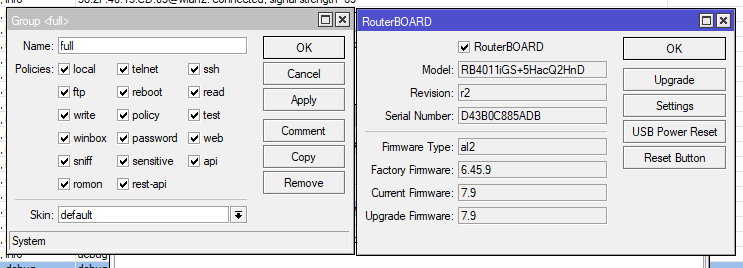

Router RB4011iGS+5HacQ2HnD
RouterOS 7.9
TheDude version ? downloaded yesterday

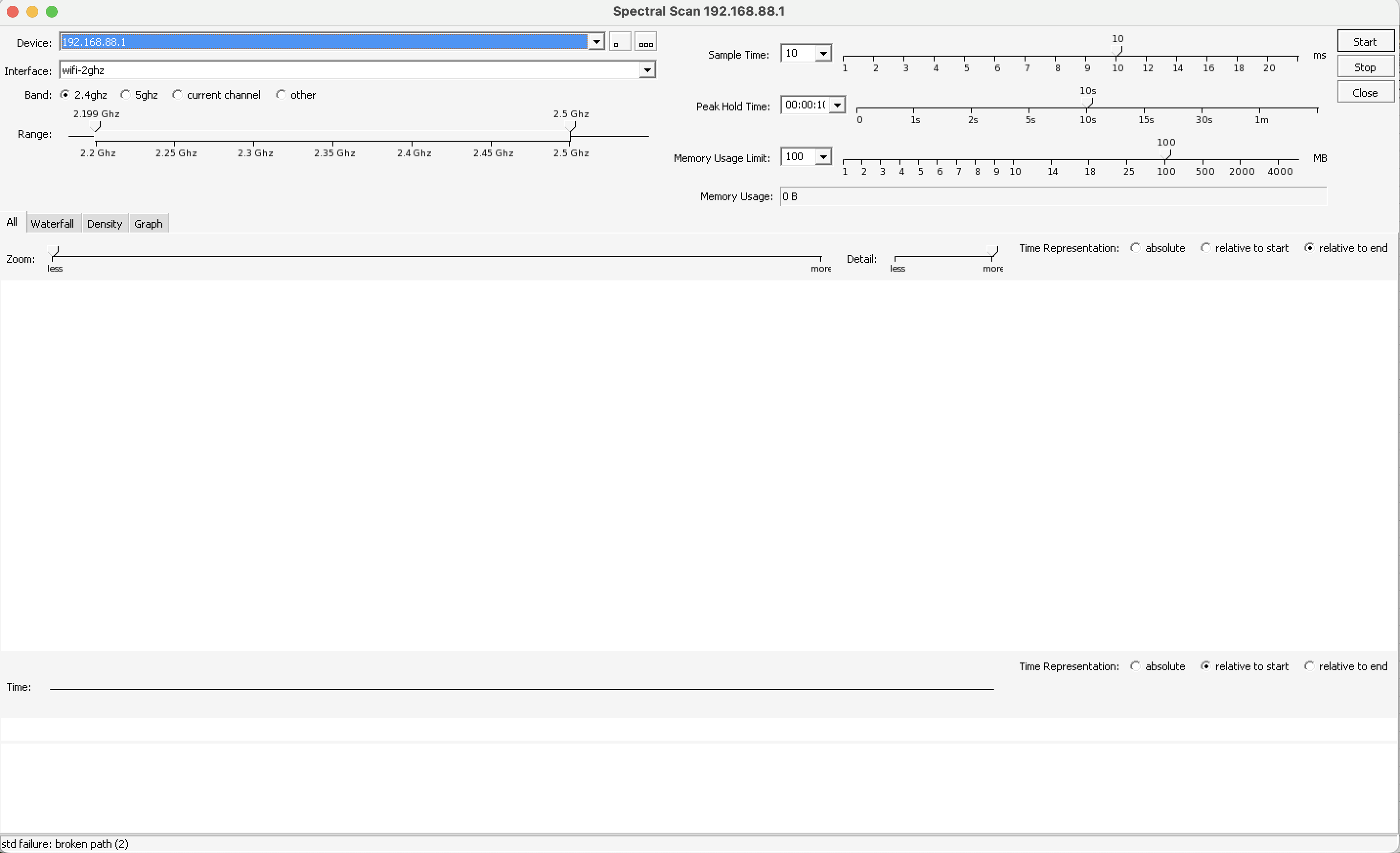

Just did a try and got slightly different error
std failure: broken path (2)
Differences from your screen
No issue with permission - just used user with full admin permissions
Can see interface in the list - in your case there is (unknown) probably because of the permissions
Versions
# NAME VERSION
0 routeros 7.11
1 dude 7.11

Screenshot

besides spectral scan maybe not supported, i can’t even see the interfaces.
but i saw some logging about login failure from local ip’s
(ip configured on the MT)
Maybe I have to reinstall the dude package
