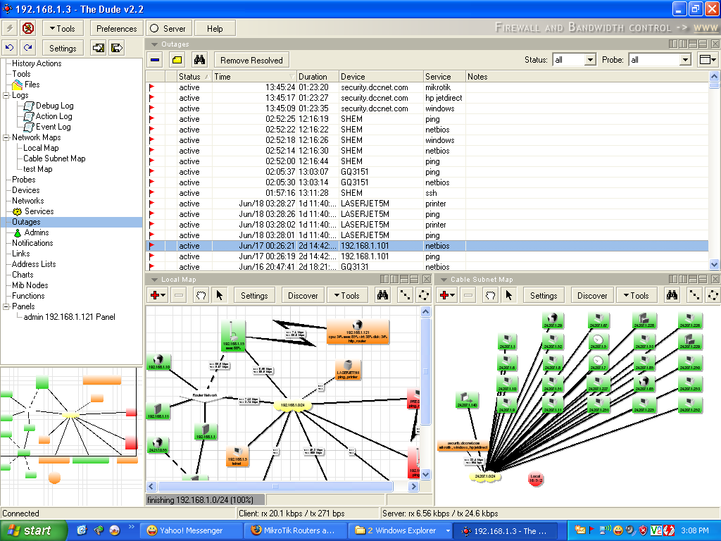

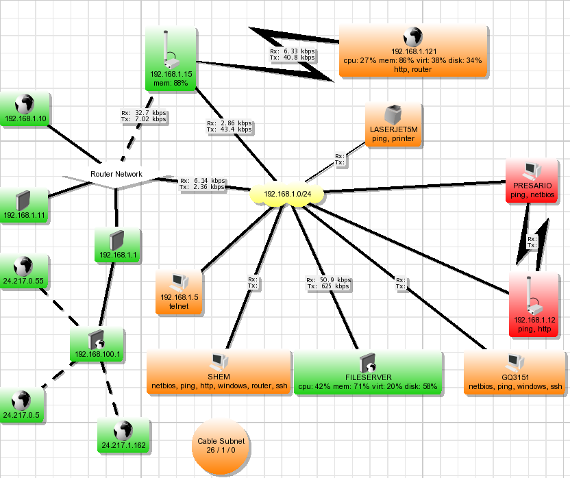

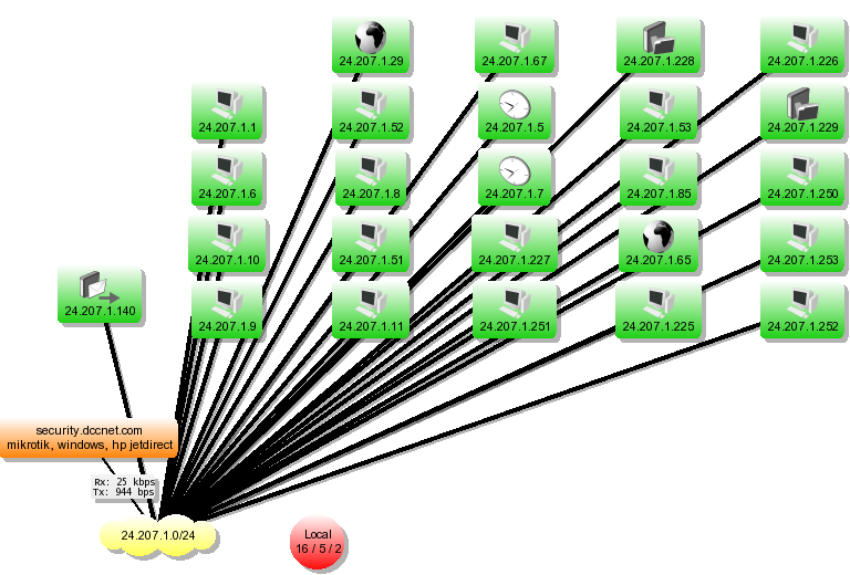

I’m not sure if you figured out what you need to do, but it is quite simple. I setup a central dude server that runs as a service on a old 533mhz box running XP Pro(Fileserver). I then make sure the machines that I use to monitor the servers are not running dude locally and only connect securely to the dude server(Fileserver) to view the maps. I have scanned my local Cable broadband subnet to see how many users on are at peek times.
It’s nothing to put an image behind these…I just need to draft the layout of my home and a few neighbors who are vlanned to me and it looks all nice a pretty.
Let me know if what I have is similar to what you are trying to do. The only added a few links and the static network to my local home network map…dude discovered everything else; once I set the subnet to discover.
I can do a howto…I’m far from an expert with this software, but I do have a decent grasp on it’s functionality.
