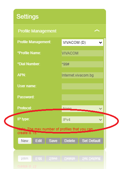

The thread is old, but this might help someone - in the profile setting there is a hidden option to disable IPv6:
In order to reach it, you’ll have to plug the modem to a PC, and to use the developer console of your browser to unhide it, to set it to IPv4 and save the profile.
That should fix the issue.

Hi siddadav! The idea is that the option to adjust the IP type could be present in the web interface, but hidden in the HTML code.
If you’re using Chromium-based browser, you can right-click at the location where the option is supposed to be present, click on “Inspect” and look for the IP type option that should be having a “hidden” property. After you remove the hidden property from the code, the option will be visualized and you can select it and save the configuration.
It is also possible that the option is not just hidden from the interface, but is missing. In that case you can flash another firmware to the modem that will enable it. I’ve already enabled a couple of modems thus way.
3dfx, your reply was like a bright light for me after trying to understand what is going on and talking with the support of Vivacom for almost 40 mins. I have a device with firmware that has the hidden html option, but even when I made it visible, the option was empty - no IPv4 or IPv6 to select. I even added it manually in the html and saved it in a different profile but without success.

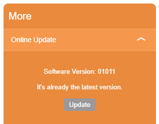

6. After the drivers are installed start the Firmware_IK41_01011_fastboot_install.bat - the script will lead you through the flash process.
3dfx, OMG! Thank you! Following your instructions and the files you provided, I managed to switch the modem’s mode, then install the drivers and after a reboot I managed to flash the firmware. I can now see the IPv4 option, and actually it is the one selected by default. In a few days I will try to plug this USB dongle to a router and check if the “one minute problem” is fixed.
Just from curiosity, where did you download this firmware from?
Thank you again!
