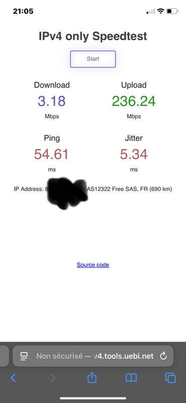

I am experiencing very slow download speeds when trying to clone a Git repository or download large files over HTTP. The download speed caps at around 100 KB/s, while the router’s CPU usage remains around 0%.
Interestingly, while running speedtest from various devices, I consistently receive results over 500 Mbps. But the download of file during this same test is still cap … (Download from the browser or from wget doesn’t change anything still 100 KB/s and from any machine linux or macOS)

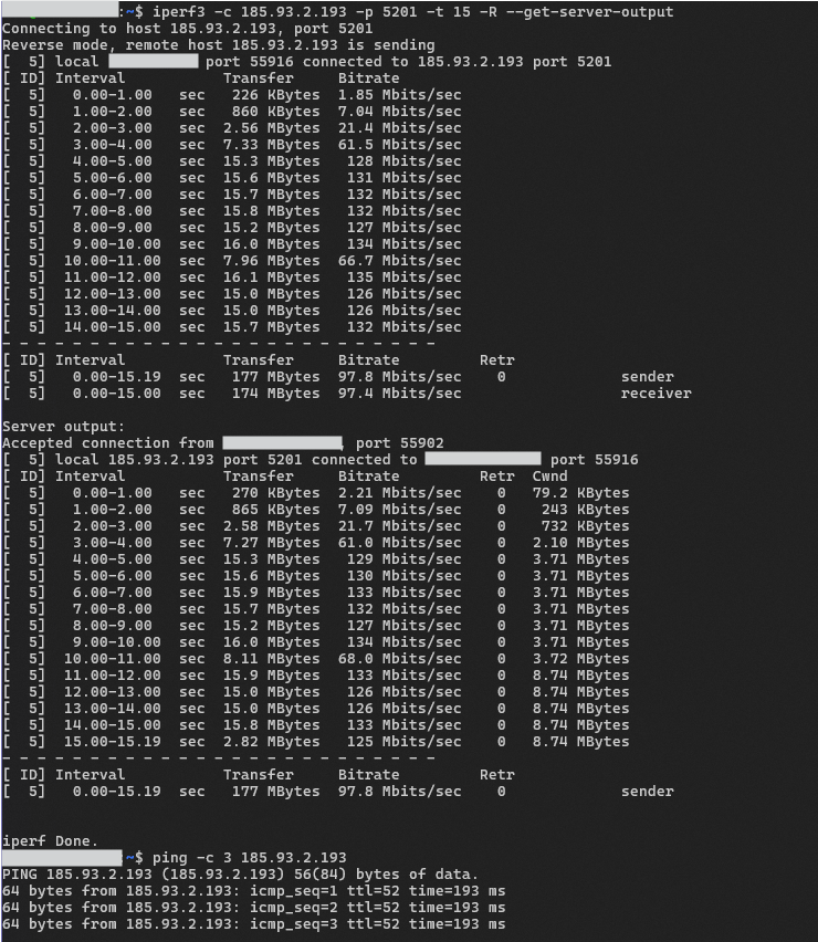

Regarding my testing with iperf, I found that when run on Linux, it performed well, in contrast to my earlier tests on macOS. Without the -R option, I achieved 500 Mbps, but using -R resulted in a drop to just 2 Mbps so it’s same as before.
Moreover, I conducted further iperf tests using the -P 20 option, which allowed for 20 streams, each conveying 2 Mbps. Does this information assist in troubleshooting?
Interestingly, when I connect through a VPN, the slow download issue disappears entirely. I suspect this might be related to my use of WireGuard, which operates over UDP, whereas the issue appears to be isolated to RX TCP traffic. Could this be an indication of a potential MTU issue, if so do you mind explaining why?

When you perform the iperf3 test with -R (the test that produced only 100KB/s), can you check on the sender side (the remote side) whether a Cwnd column is available? and which values does that column have?
Here the result what are you looking for?

FYI on linux you can get the server output with
iperf3 -R --get-server-output -c 185.93.2.193
Yes, thank you. The congestion window (for the sender side, on your side this is further limited by the receive window) is way too small. And has no chances to increase before encountering a lot of retries (probably due to packet loss). It looks like the round-trip delay from you to the iperf3 server is about 18-20ms. When there are retries the sender side had to reduce the congestion window (cf congestion avoidance algorithms), as you can observe. It looks like retries are needed when the Cwnd is larger than 30KB.
If you use a bandwidth delay product calculator, like this one https://calculator.academy/bandwidth-delay-product-calculator/ or this one https://www.speedguide.net/bdp.php, you’ll see that if the congestion window can’t get bigger than those numbers, you won’t get higher bandwidth. That’s also why if you make 20 connections with -P 20, the sum of the bandwidth is larger, because it looks like the Cwnd limit is about the same for the individual connections. For comparison, here is a test from my place to the server of yours. I’m located in a different continent with a much higher ping time (193ms), and the congestion window can steadily increase to 8.74 Mbytes without retries:
My bet is that when you remove the -R option, the sender side (you) can achieve much much larger Cwnd sizes. When you perform iperf3 tests between your VLANs, do you see large or small Cwnd values? Because the delay within your LANs is much smaller (sub ms) you might not notice the effects of a limited congestion window on the final bandwidth.

64 bytes from 185.93.2.193: icmp_seq=3 ttl=58 time=3.07 ms
64 bytes from 185.93.2.193: icmp_seq=4 ttl=58 time=2.60 ms
64 bytes from 185.93.2.193: icmp_seq=5 ttl=58 time=2.68 ms
--- 185.93.2.193 ping statistics ---
5 packets transmitted, 5 received, 0% packet loss, time 4006ms
rtt min/avg/max/mdev = 2.602/2.993/3.442/0.315 ms
Locally between two desktop not on the same VLAN I have no Retr and Cwnd is bigger and I saturate the GB link

and with -R
Accepted connection from 192.168.43.251, port 54910
[  5] local 192.168.11.3 port 5201 connected to 192.168.43.251 port 54926
[ ID] Interval           Transfer     Bitrate         Retr  Cwnd
[  5]   0.00-1.00   sec   113 MBytes   951 Mbits/sec    0    452 KBytes
[  5]   1.00-2.00   sec   111 MBytes   930 Mbits/sec    0    452 KBytes
[  5]   2.00-3.00   sec   110 MBytes   926 Mbits/sec    0    519 KBytes
[  5]   3.00-4.00   sec   111 MBytes   933 Mbits/sec    0    542 KBytes
[  5]   4.00-5.00   sec   112 MBytes   937 Mbits/sec    0    663 KBytes
[  5]   5.00-6.00   sec   111 MBytes   933 Mbits/sec    2    619 KBytes
[  5]   6.00-7.00   sec   110 MBytes   923 Mbits/sec    3    491 KBytes
[  5]   7.00-8.00   sec   111 MBytes   933 Mbits/sec    4    489 KBytes
[  5]   8.00-9.00   sec   111 MBytes   933 Mbits/sec    0    509 KBytes
[  5]   9.00-10.00  sec   110 MBytes   923 Mbits/sec    0    580 KBytes
[  5]   0.00-10.00  sec  1.09 GBytes   932 Mbits/sec    9             sender
Problem with using public servers (including iperf3 servers) is that there might be bottlenecks other than “last mile”. I tried iperf3 server from the screenshots of @CGGXANNX and I got shitty performance in both directions. In both directions I see fair amount of retransmissions … and for TCP retransmissions are sure way to kill any kind of performance (retransmission both means re-sending data and it shrinks TCP window to portion of what it could be, so throughput in next few seconds is low even without retransmissions). If I tried a few other public iperf3 servers, I was getting various results (but all of them were better and more consistent than the ones I got from server from mentioned screenshot.
So when determining performance of router, it’s important to be 200% sure that there are no other bottlenecks.
I agree with you, Mkx, but I ended up doing this test with iperf because I had very slow internet speed over IPv4, such as when pulling from GitHub. The issue disappeared the moment I used a VPN, even in the same location (city).
Also, I tested the same iperf server with the equipment provided by my internet service provider instead of the CCR, and I got good results with no retries. The issue is that I don’t want to keep this equipment because it’s very old, and I have my own gear.

I also have the same issue, only my ipv4 download is very slow 100kb/s maximum
