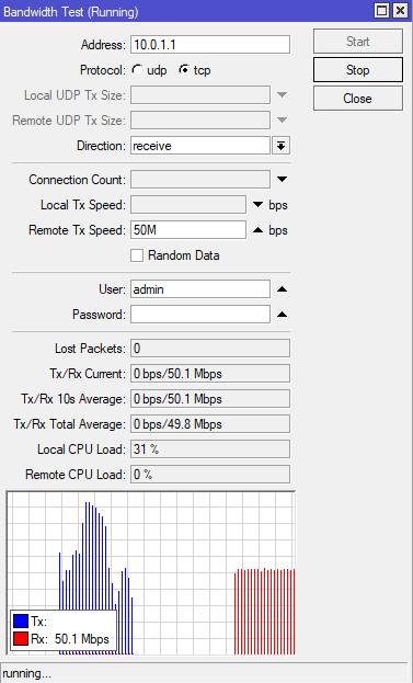

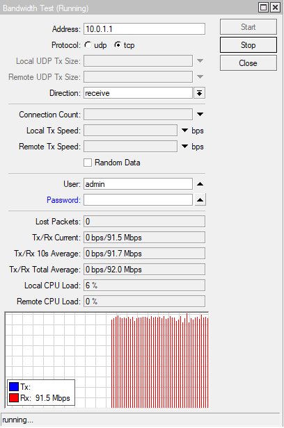

but if for example I limit the test to 50M, it works stably..
Summary

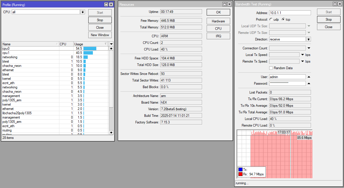

as i already added above, i reproduced the same problem, on hex refresh, then i downgraded it to 7.15.3 and the problem remained, then i upgraded it to 7.20beta6 and the problem seems to have been solved, i need to check on ax lite, i’ll write a little later
Pets, kids & adults learn by experience.
Hex Refresh ether 1 speed issue was solved with 7.20beta5.
On AX Lite that issue is non-existant.
I still don’t see WHAT the problem is …
i use ether3…
good news, for hex refresh it’s fixed in 7.20beta6

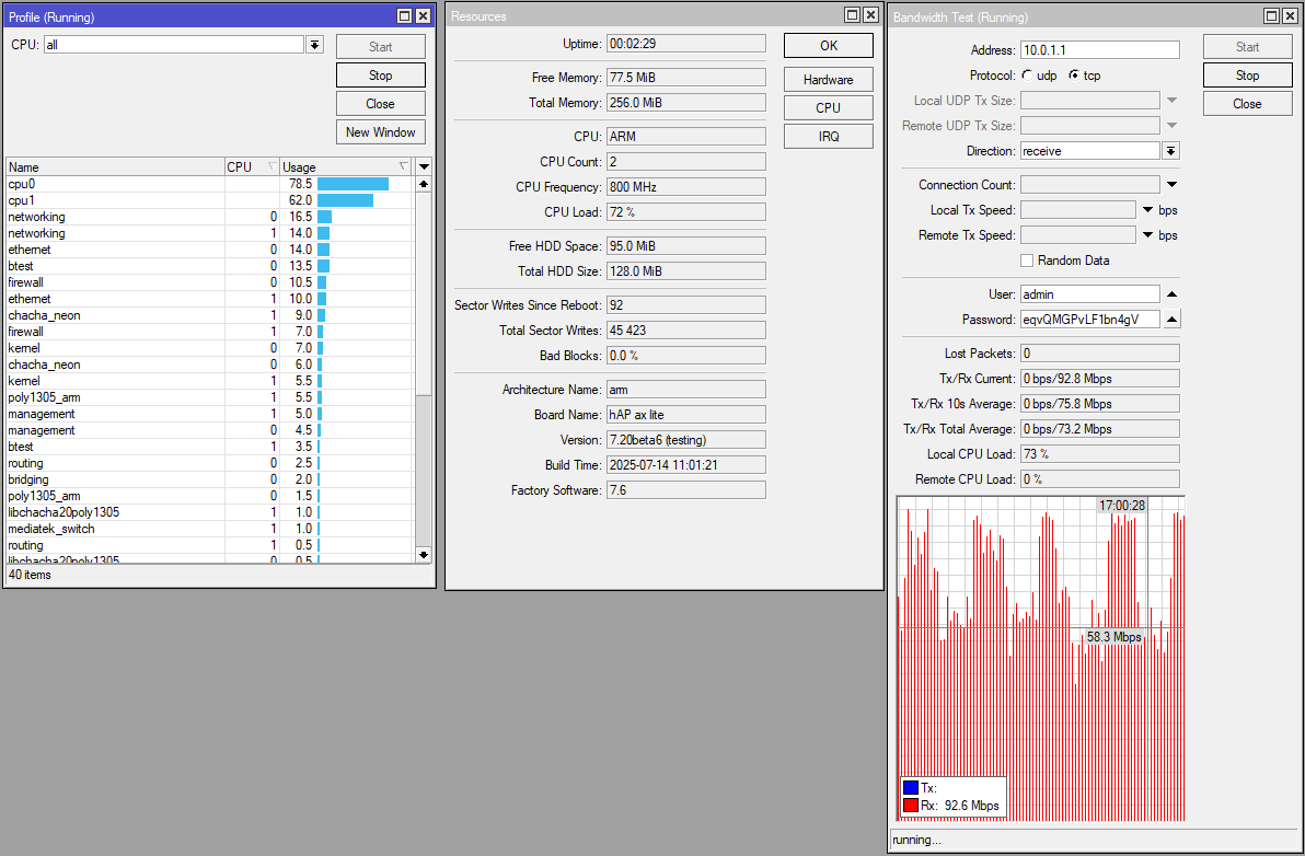

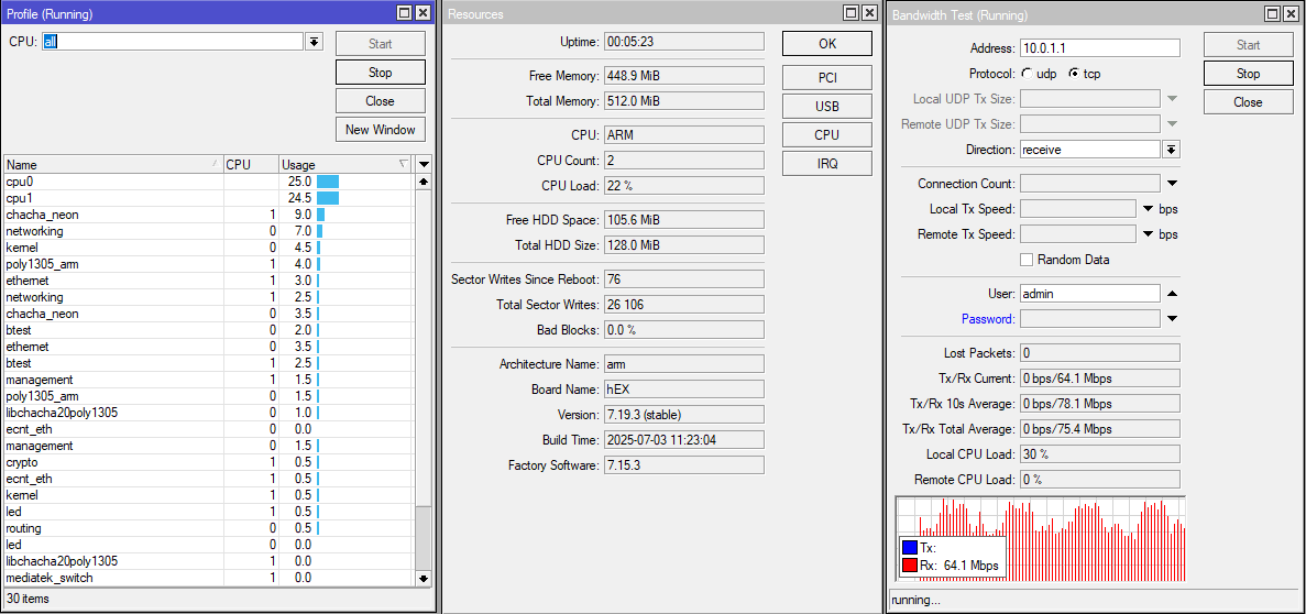

hex_refresh_7_20beta6
Summary

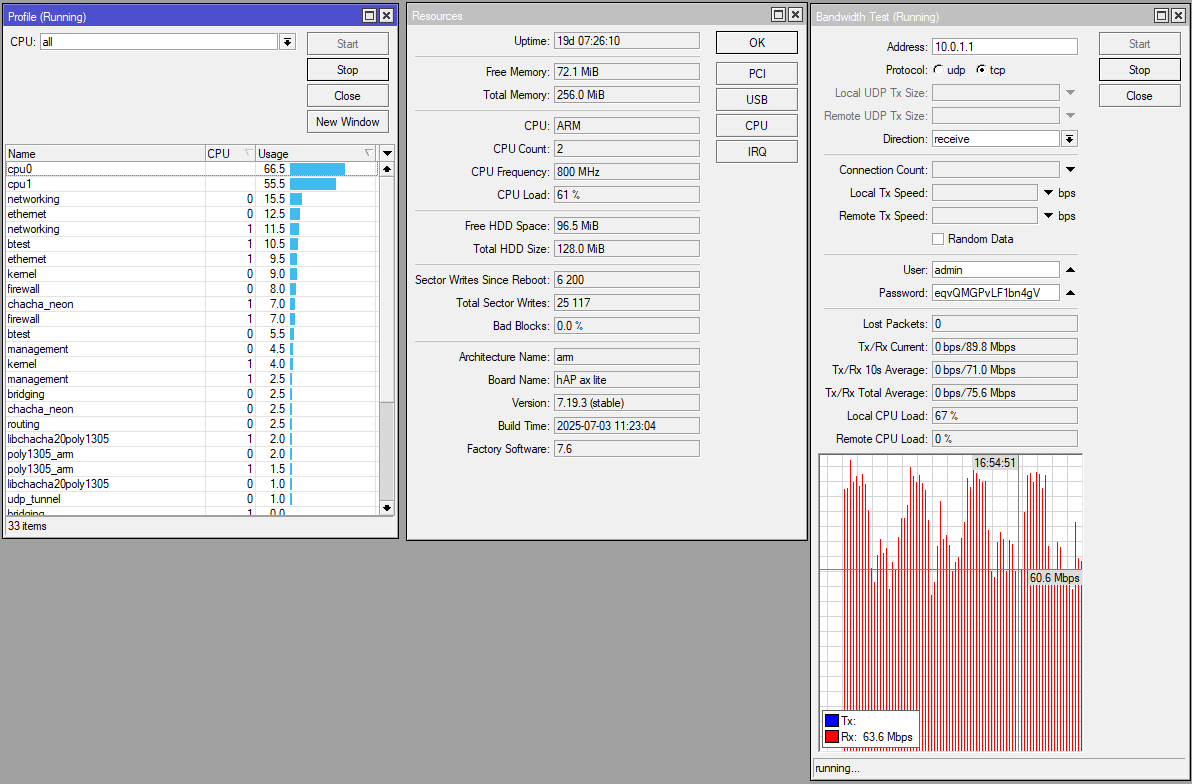

ax_lite_7_19_3
Summary
ax_lite_7_20beta6
Summary
