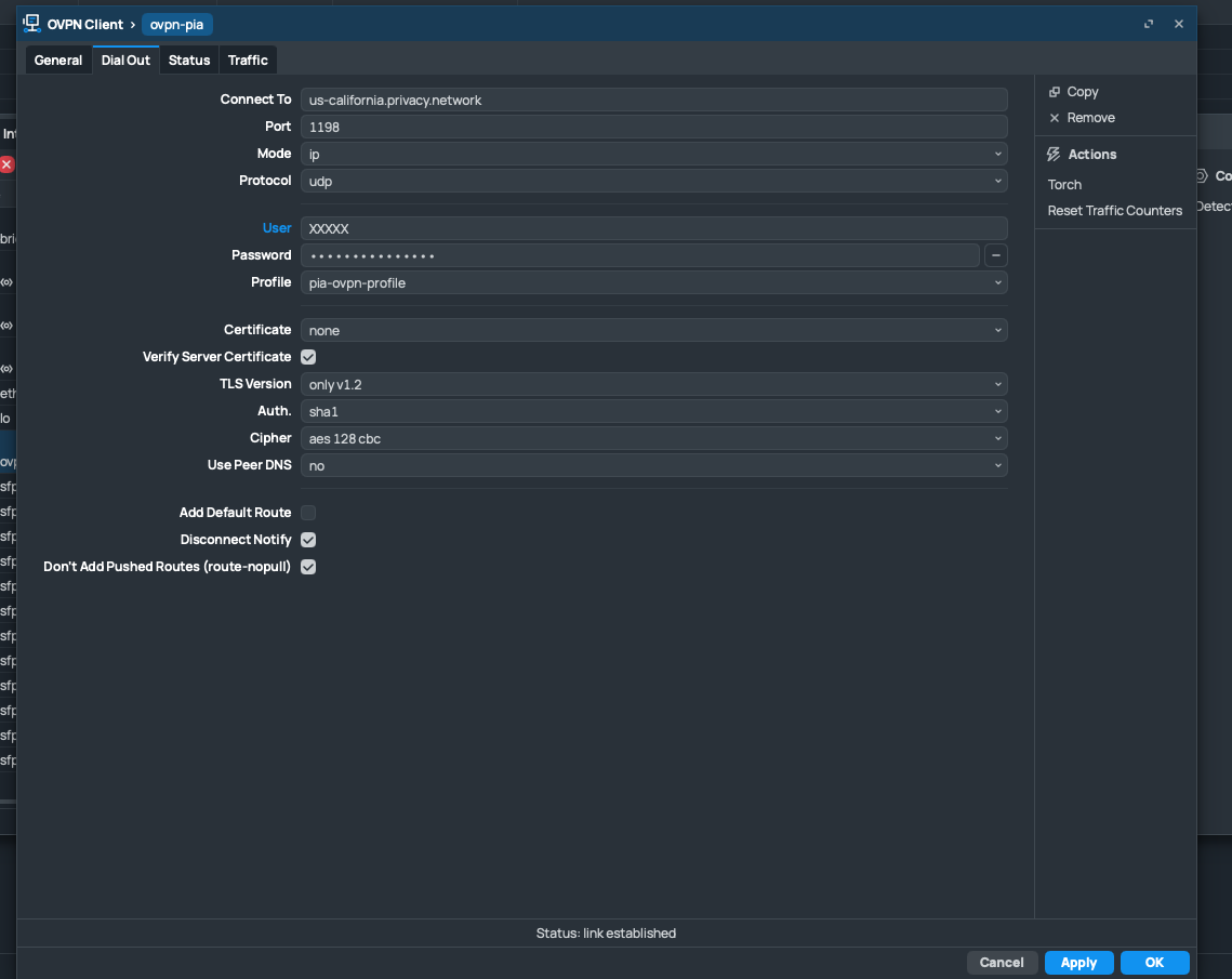

ovpn client settings:

This is the output of my ovpn-client:
Flags: X - disabled; R - running; H - hw-crypto; Ta - tls-auth; Tc - tls-crypt
 0  RH     ;;; OpenVPN Client for Split Tunnel
           name="ovpn-pia" mac-address=02:D5:B2:93:AE:54 max-mtu=1500 connect-to=us-california.privacy.network port=1198 mode=ip protocol=udp user="XXXX" password="XXXX"
           profile=pia-ovpn-profile certificate=none verify-server-certificate=yes tls-version=only-1.2 auth=sha1 cipher=aes128-cbc use-peer-dns=no add-default-route=no route-nopull=yes
           disconnect-notify=yes

I guess the core issue was that there appeared to be a routing conflict where my VPN-marked traffic was incorrectly trying to access local resources via the VPN tunnel (according to Gemini).
As an alternative, I tried adding a dst-address-list=!LAN_Networks to the mangle rules (I did change the address list from dst-address-list back to src-address-list). Below are my final mangle rules without dst-address-list=!LAN_Networks
0    ;;; Mark connections from VPN_Addresses
      chain=prerouting action=mark-connection new-connection-mark=vpn-connection passthrough=yes src-address-list=VPN_Addresses log=no log-prefix=""
 1    ;;; Mark traffic from VPN_Addresses
      chain=prerouting action=mark-routing new-routing-mark=vpn-routing-table passthrough=no connection-mark=vpn-connection log=no log-prefix=""
I first tried adding it to rule 0, then tried adding it to rule 1. Neither worked. Not sure why.
What would you recommend to make my marking more restrictive? or having the two rules like I originally had is what you were referring to?
Also I looked at trying to do routing rules instead of marking and couldn't find a way to do it in RouterOS 7 (I'm sure I missed something).
As for the Drop all forward traffic rule - why do you recommend removing it? Attached is my full firewall list. I tend to keep my LAN-WAN traffic restrictive so I can manage what devices send out of my network a bit better.

Please correct me if I'm wrong, but it seems like RouterOS 7 won't allow us to use a routing-mark that isn't the routing table. I try commands to change the routing mark and it doesn't find it and if I go into the UI for the Mangle rules the only options that are listed are the Main Table and the VPN table I have already.
Yes, the routing mark used for the rules does need to be in / routing table
it also needs to be in fib (I am not sure why it needs to be in the fib)
Yep. A bit more on this:
FIB is needed, because you actually want to forward traffic according to your table.
Thanks for the clarification guys. Appreciate it. So what I currently have configured works but I suspect there's probably a better, more accepted way to do the split-tunnel. Can you guys please help me "gut check" my configuration? And if I need to make changes, please help clarify what and where?
Notes about the configurations below:
  • I have an alternate NAT rule (disabled currently) that is more strict for VPN traffic "Strict NAT for VPN-routed traffic" - do you think I should use that one instead of the one I am currently using?
  • The change in my config that got the split-tunnel to work was to add an IP Route for LAN/local traffic to bypass the VPN tunnel - "LAN: Ensure local traffic bypasses the VPN tunnel"
(Let me know if you need me to post my firewall rules again)
Thanks again for your help!
