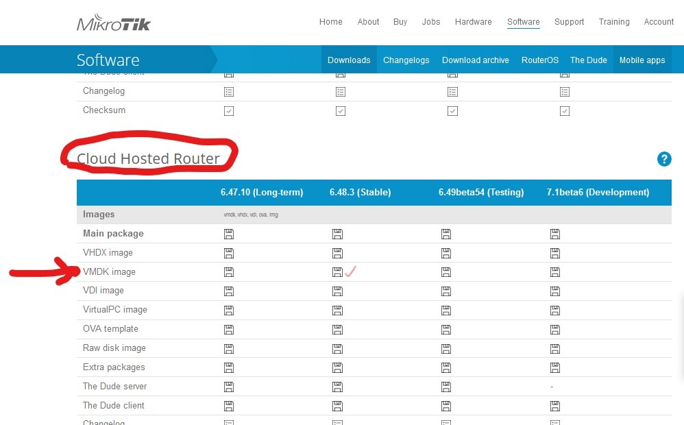

This happens when you use Router Os …*.npk file.
Download the Cloud Hosted Router (CHR) image from https://mikrotik.com/download (See attached Screenshot)
Follow the same procedure as stated in the Ene-ng documentation (how to guide)
https://www.eve-ng.net/index.php/documentation/howtos/howto-add-mikrotik-cloud-router/
You can watch the illustration by The Network Berg here https://www.youtube.com/watch?v=kmJVScuCzIM
Enjoy.
