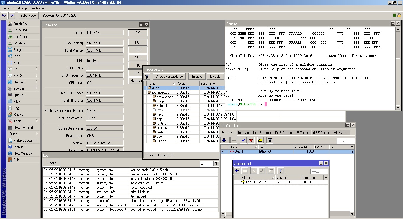

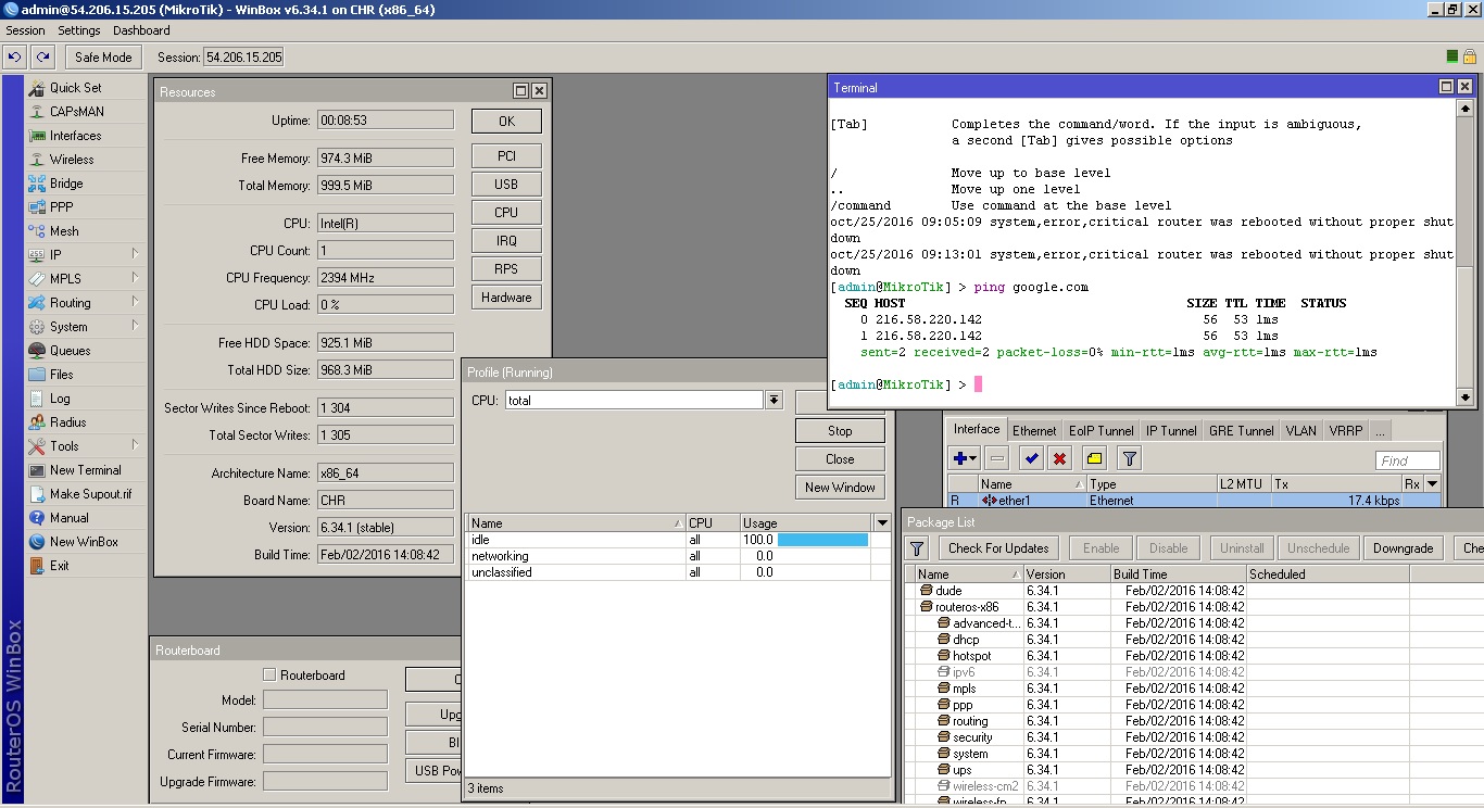

Hi all.
Just did an Amazon Web services test of Mikrotiks RouterOS with the available amazon marketplace release of RouterOS v6.34.1.
As it was just a test I did an upgrade to v6.38rc15 which went smooth..
I used the t2.micro ( Free tier ) for the test. It took me about 2 minutes from starting the whole process from the marketplace to getting a winbox link up.
Anyhow attached is a couple of screen shots of it running with winbox pics.
I briefly tested webproxy too and found that worked well..

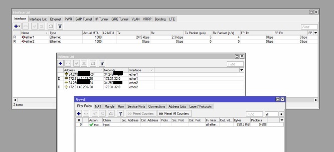

Hi. I succesfully spun up an AWS CHR instance (6.38.1), BUT if I attach a second network interface to the instance, it will show as Running in Interfaces with correctly assigned IP address, but otherwise be completely dead (not reachable neither with www nor Winbox). Eventually the whole instance gets unstable and unreachable. Bug, or am I doing something wrong?
I had similar problems and finally decided to not use CHR on AWS.
Regards,
Please check the AWS documentation or describe in detail - what actions did you perform to get to the conclusion that this is not working - in my testing secondary interface correctly was added and changing assigned address on the interface did not cause any issues with the connectivity to the running instance.
edit:
The test was done with 6.38.2 on EC2 instances. And as there are the requirement to have an Elastic IP for the instance if you are using more than 1 interface.
Also, check your security settings for the network as traffic might be blocked by the internal Amazon firewall.

Err… I think I have described in detail. it’s pretty straightforward. I only need an external IP on one interface, so don’t need to provision additional Elastic IP as instance is born with an external IP. Other than that, second internal IP is assigned to second Network Interface. But only one interface is reachable at a time. Both interfaced share the same security group which allow incoming winbox.
from what network did you have the local IP address that was assigned to the interfaces? Also, as Amazon states in the documentation, assigned IP address is NATed only to one internal Ip address and the virtual interfaces cannot communicate between themselves.
This is my test-setup right now, internal network 172.31.32.0/20 is provided by AWS . Added a Elastic IP to ether2 to see if it made a difference. For the test I am connected to AWS via site-2-site using AWS VPN functionality (hardware MT in my end). Should I not be able to ping ether1 internal AND ether2 internal from my end? Right now, I can only ping ether1.. If i disable ether1 in MT, I can ping eher2. If I reenable ether1 I can still only ping ether2.
2017-02-03 14_30_23-PARCOVET - TeamViewer - Gratis licens (kun til ikke-kommerciel brug).jpg
As I have understood from the AWS documentation - this is how it works. You have to look into VPS setups how to create local network or how to create a tunnel from AWS to your network. In AWS fabric these interfaces are not connected in any way.
