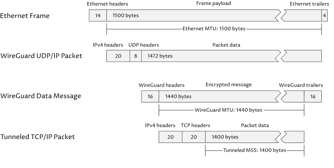

UDP is used to transport the outer packets, the ones that contains the encrypted data. Those packets can still be up to 1500 (assuming your ISP support MTU 1500 for your internet connection) byte large and will be transported without problem.
The MTU that you set on the WG interface (1420 in your configuration) is set for the IP (IPv4 and IPv6) packets inside the WG tunnel. Normally, if you want to transport an IP packet of size X inside the WG tunnel, without having to break (fragment) that packet in multiple part, then you have to ensure that that packet does not exceed a certain sizes. What is that size?
If the outer transport uses IPv4, then there will be overhead from IPv4 and UDP and WG, which result in 60 bytes headers and footers. Which means if you don't want fragmentation, the MTU of the packets inside the tunnel (the packets that will be encrypted) cannot be larger than the outer MTU - 60. If your ISP supports MTU 1500, the you should not set MTU of the WG tunnel larger than 1440.
If the outer transport uses IPv6, then there will be overhead from IPv6 and UDP and WG, which result in 80 bytes headers and footers. That's why you see the default MTU of WG interfaces set to 1420, because that's assuming the case of outer MTU 1500 and IPv6 used to transport the outer packets with the encrypted data.
Inside the tunnel, you can transport any IP packets, so IPv4 and IPv6 are supported, and of course TCP, UDP, ICMP, anything supported by IP can be transported. Is just that the MTU has been reduced (due to the overhead of the outer packet).
This is an illustration taken from this page:
When your Mac runs the SurfShark client and you use the Web browser to surf websites, the apps and macOS still produce normal IP packets for DNS queries (UDP & TCP) as well as packets for the connections that uses TCP or QUIC (which is UDP). The difference is that those packets are not sent directly to the internet through your ISP, but are first encrypted and encapsulated with special headers and footers (WG header and footer and UDP and IPv4 headers). If the browser tries to make a TCP connection to forum.mikrotik.com then you still have a TCP connection, it's just that the individual packets of that TCP connections are first encrypted and then wrapped in UDP packets.
Most probably because PMTUD is working correctly with Proton. For example, when the remote hosts (such as forum.mikrotik.com) send response packets back to you, and those packets are large (IP packets up to 1500 bytes), the Proton knows to notify forum.mikrotik.com with ICMP packets that fragmentation is needed (IPv4) or packet is to big (IPv6), and forum.mikrotik.com will know to reduce the size, until the packet can be smaller than 1420 bytes.
SurfShark might not be doing that correctly, so forum.mikrotik.com keep sending large packets that SurfShark cannot let through and just drops them without telling forum.mikrotik.com.
