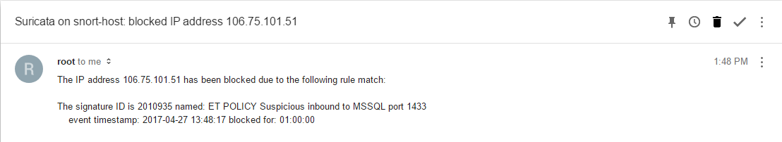

Updated 27-April-2017
  • Added email notification function in suricata_block.php

    if ($email_alert) {
      $to      = $email_to;
      $subject = 'Suricata on ' . gethostname() . ': blocked IP address ' . $thisrow['que_ip_adr'];
      $message = 'The IP address ' . $thisrow['que_ip_adr'] . " has been blocked due to the following rule match:\r\n";
      $message = $message . "\r\n";
      $message = $message . "The signature ID is " . $thisrow['que_sig_gid'] . " named: " . $thisrow['que_sig_name'] . "\r\n";
      $message = $message . "    event timestamp: " . $thisrow['que_event_timestamp'] . " blocked for: " . $timeremaining . "\r\n\r\n";
      $headers = 'From: ' . $email_from . "\r\n" .
        'Reply-To: ' . $email_from . "\r\n" .
        'X-Mailer: PHP/' . phpversion();
      mail($to, $subject, $message, $headers);

  if ($email_alert) {
    $to      = $email_to;
    $subject = 'Suricata on ' . gethostname() . ': blocked IP address ' . $target;
    $message = 'The IP address ' . $target . " has been blocked due to the following rule match:\r\n";
    $message = $message . "The signature ID is " . $thisalert[1] . "\r\n";
    $message = $message . "    event timestamp: " . $thisalert[0] . " blocked for: " . $block_time . "\r\n\r\n";
