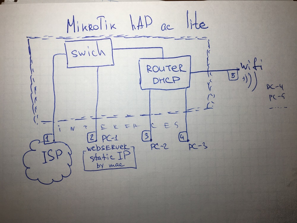

Hi there,
Is it posible inside a single device (hAP ac Lite) as below configuration?:
ISP on the first interface;
webserver on the second (ISP provide a static IP by mac address here);
3,4 interface + wifi - other devices (dynamic IP).
It is important that the webserver and other devices will be isolated each other.
Thanks.

Yes. One ISP, two external IP. I need to give one IP to the webserver and one to the router (dhcp) so that the webserver and other devices ended up in isolation from each other.
I add a one bridge with ISP port and webserver port. Next: second bridge with all others ports. But how will the Internet get into the second bridge? And what about dhcp server and dhcp client?

Now I have done this:
bridge-1 = ISP port + web server port
bridge-2 = all other ports
bridge-2 ports connect among themselves, but how to connect it with the ISP?
What are your speed requirements? The easiest way to configure what you want is to use two bridges, but you device can only have one hardware-accelerated bridge. If your WAN is relatively slow I’d say go this way, with LAN bridge with hardware acceleration and WAN bridge in software.
Another way would be to add all five ports to a single bridge, and then isolate ports from each other using VLANs, but this is going to be more complicated.
