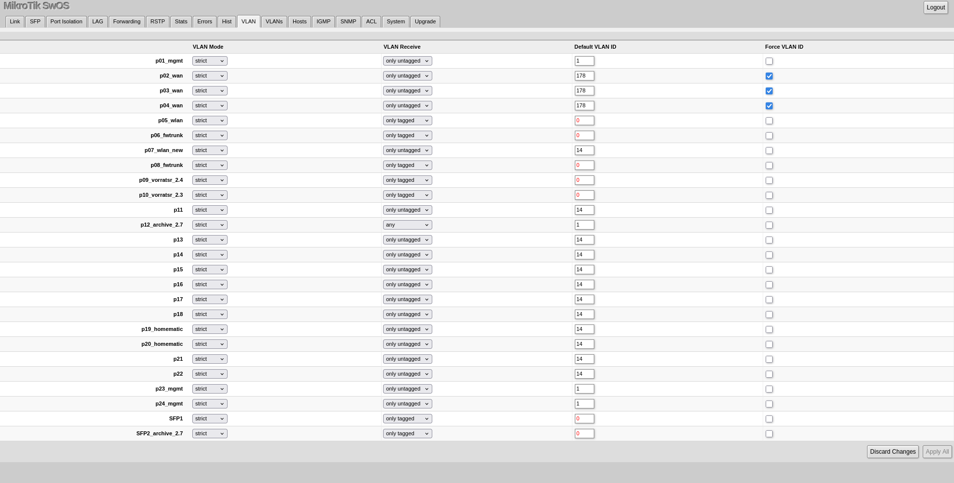

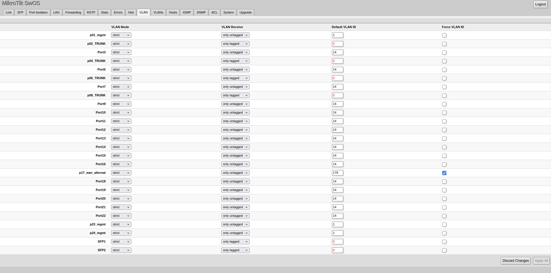

The dumb PoE switch is connected to port 5 of my upstairs CSS326.
CSS326 upstairs:
CSS326 downstairs:
You can’t use VLAN 0, this is not part of 802.1Q standard, and the web interface clearly shows it with the red font.
Switch documentation is also clear about what values are supported:
Default VLAN ID (integer: 1..4095; Default: 1)
https://help.mikrotik.com/docs/spaces/SWOS/pages/76415036/CRS3xx+and+CSS326-24G-2S+series+Manual#CRS3xxandCSS32624G2S+seriesManual-VLANandVLANs
Well, not that clearly. Plot twist: I’m colorblind :laughing:
Thanks a lot. I never set the VLAN manually to 0, but kept it at whatever the default was years ago.
