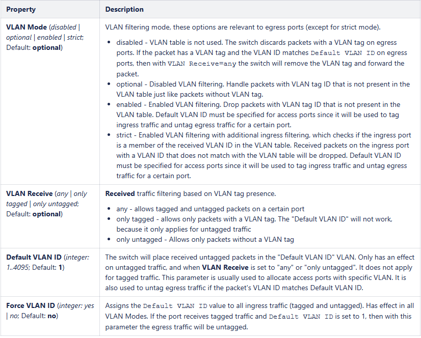

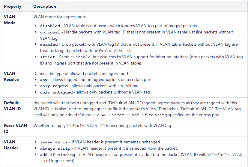

The VLAN mode documentation for the CSS106 and at least CSS326 are not consistent. Specifically on the CSS106 it says vlan mode applies to ingress port, but the CSS326 it says the vlan mode is relevant to egress ports. The CSS106 has a separate VLAN header setting but it isn't clear to me if this is applied on ingress or egress. Also different is the documentation for the vlan mode disabled.
SwOS doesn't seem to have a global setting to turn vlan-aware mode on and off, unlike the ROS bridge does with the vlan-filtering option. Instead it is configured per port.
Here is what the RB260 (CSS106) "manual" says:
And here is what the CSS326 "manual" says:

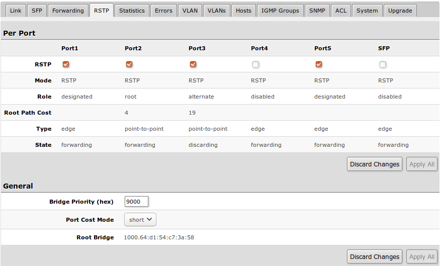

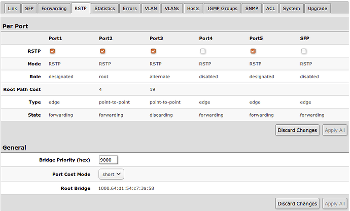

This "manual" section shows this screen (not correct for v2.18)

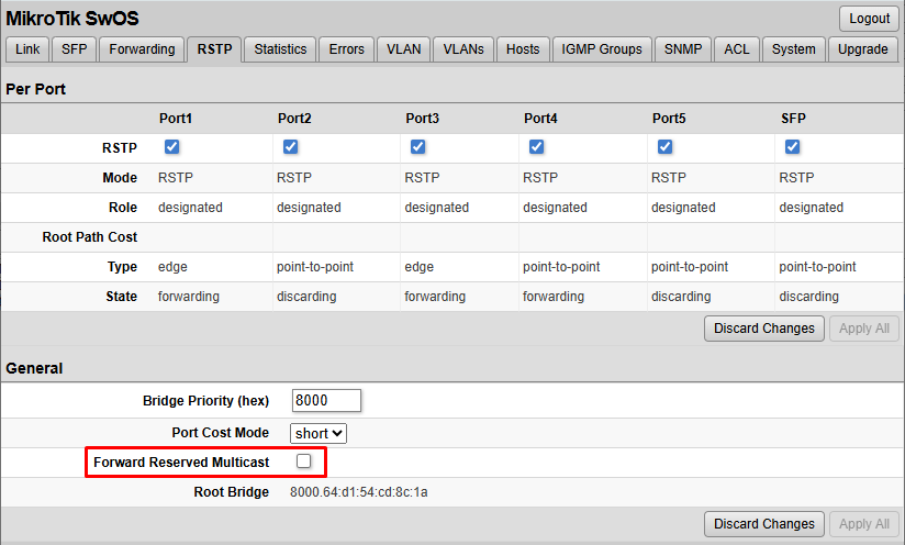

Here's what my CSS106 (with SwOS v2.18) RSTP screen looks like: (red box added by me)

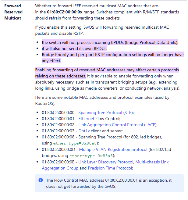

The text of the manual does describe the Forward Reserved Multicast functionality.
I haven't tested it, but if it does what it says it does, then it may fix @chechito's complaint here RSTP not working properly on CSS106-5G-1S - #4 by chechito but it does not seem to allow setting this on a port by port basis.
Here's what the text says as of 2026-02-16
