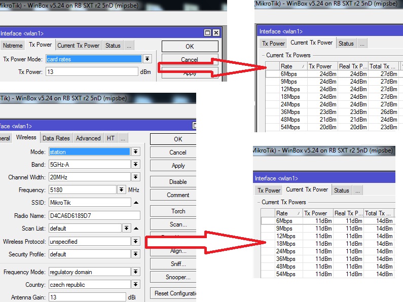

There is small bug with regulating tx power.
When i use card rates - then current tx power is still maximum.
Regulatory domain works well. See image.
The same problem in 5.24 and 6.0rc11
Honzam, This is a hardware limitation. You must use “All rates fixed”

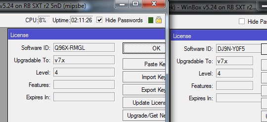

RB Pages say - level 3. http://routerboard.com/RBSXT-5nDr2
But all our SXT lite5 have Level4.
It concerns only the first pieces?

Some of the first pieces had Level4 as a bonus. Regular production run will have L3 as specifications indicate. Congratulations ![]()
So this means that this is not going to change with newer versions of ROS or SXT hardware? Aren’t there any issues when using all-rates-fixed?
