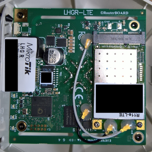

LHGR Pigtail’s

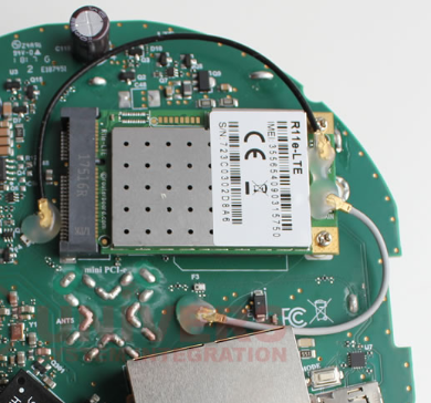

SXTR Pigtail’s
Photo source: https://www.unisi.ru/news/RBSXTR%26R11e-LTE/

MikroTik RouterBoards with internal soldered LTE antenna SXTR, LHGR, LDFR use on their PCB the Male u.FL = IPEX = IPEX1
MikroTik LTE modules/modems R11e-LTE, R11e-4G, R11e-LTE6 … and Quectel EP06-E, EP06-A are the miniPCIexpress/mPCIe devices and use the Male u.FL = IPEX = IPEX1
Lenght are 4cm and 8cm.
When we want use a mPCIe adapter to use M.2 slot modems like Quectel EM12-G, EM18-G, EM120R-GL, EM160R-GL etc. then they use Male IPEX4 = MHF4
This means we must use Female - Female connector.
u.FL= IPEX Female ← [5,10,15]cm → MHF4=IPEX4 Female
