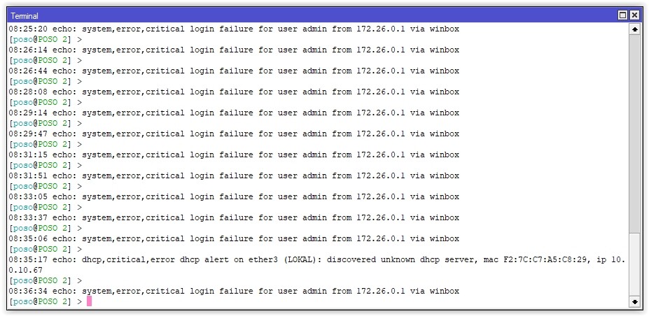

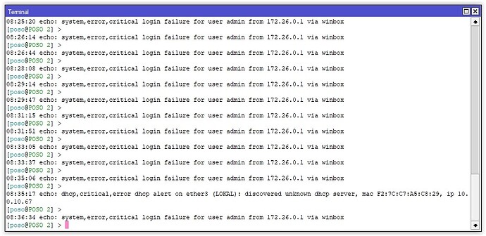

i have recent problem..
someone/thing tried to login via winbox but from the router IP itself (172.26.0.1) pics attached..
please, need help..
thank you..
Hopefully, you have already disabled the admin password and only use a trusted one you created. As noted, you should set up access so that only IP addresses from within your LAN can use winbox or HTTP to the router.
this looks more like TheDude … Probably added the device and now its trying to log in (enabled by default). find the device and uncheck “router OS” option in the details page.
