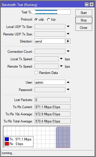

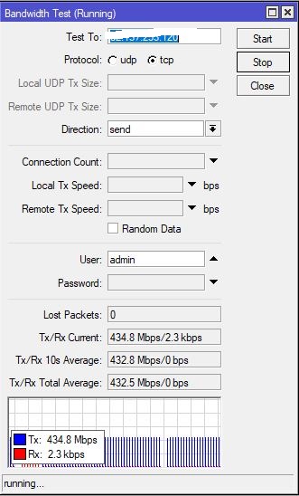

Hello guys,
I approve this issue too in v6.44.6 long-term on both x86 and Mikrotik 750G r3
UDP : ~950mbps
TCP: ~512mbps
I hope this could be solved as soon as possible

Unfortunately, this didn’t do any improvement in my case, I use ethernet ports and multiple MT routers, and the problem is between 2 Mikrotik routers.
