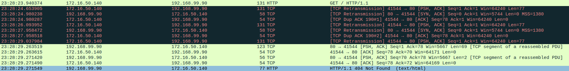

One of the VPN clients provides an HTTP Server on Port 80. The clients on 90 can access it fine. But the Servers on 50 can access it, just with very high latency. Checking with Wireshark showed that there are TCP Retransmissions.
With some testing, I figured out that my drop invalid firewall rule on the Mikrotik Router is the culprit. As soon as I disable the drop invalid on the forwarding chain the issue is gone and the requests are working without delay. Any idea why?

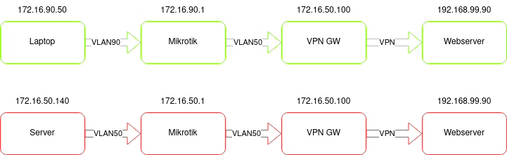

The VPN GW provides multiple purposes. The purpose which causes issues here is providing access to a remote Webserver. In the diagram, the green one shows the way which works without TCP retransmits, and the red one shows the way with the delay and TCP retransmits.

The TCP SYN from the Server is being sent to the Router and the Router forwards it to the VPN-GW in the same Subnet, which then routes the Packet to the VPN Client.
But as they are in the same Subnet, the TCP SYN/ACK is sent directly from the VPN-GW to the Server.
Because of that, the Router can’t track the Connection and drops it as invalid.
