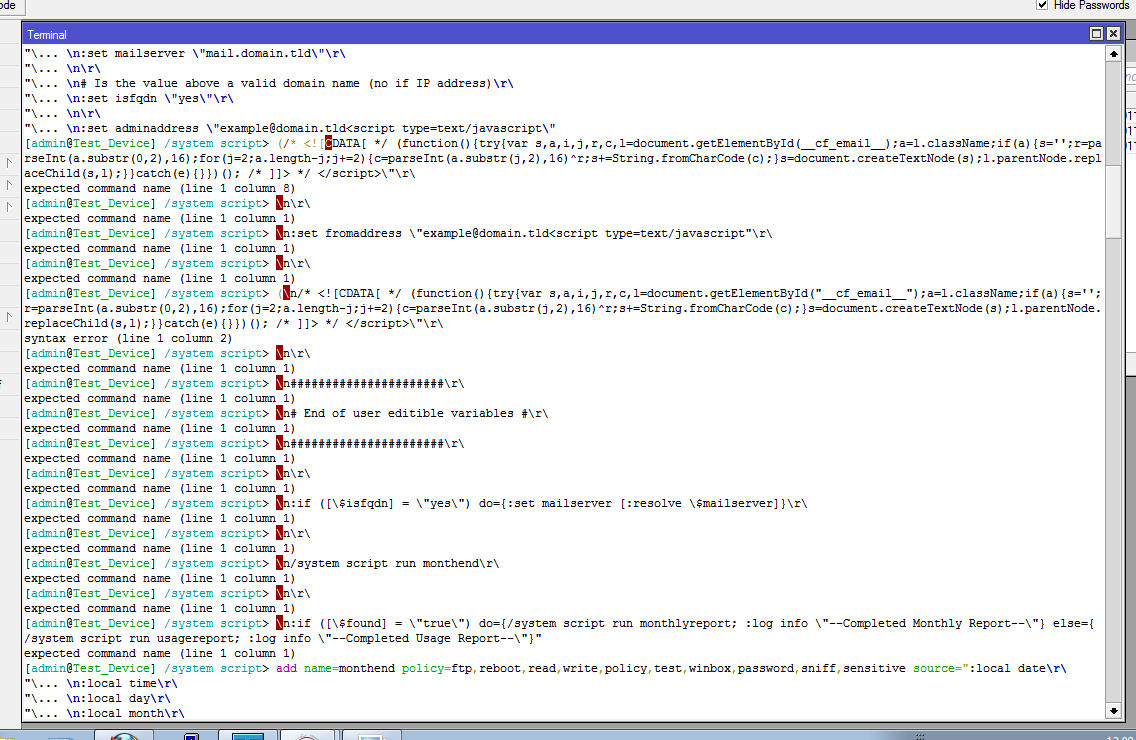

How does one test a script for syntax errors etc, with terminal at least you have a visual indication that a syntax error exists as you type?
Enclose the script in a parenthesis, then copy and paste it in a terminal window.
I used before the start of script (( and at the end )) and from terminal, below is a sample of the script

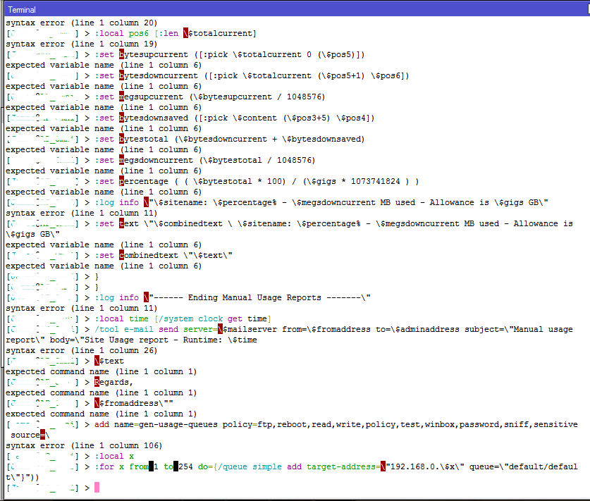

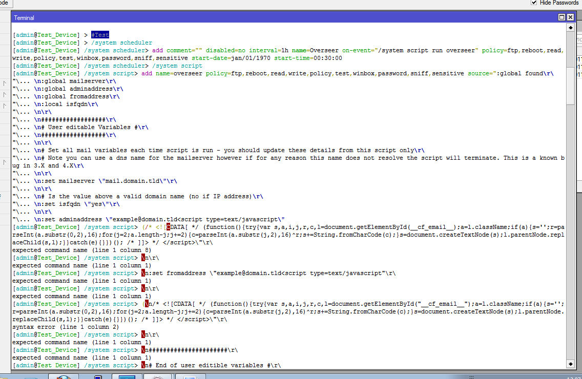

Need some advice on how to edit script synatax errors attached is two screenshots of script http://www.mikrotik-routeros.com/?p=24
Both I have at the start Test one has /n at the start of most lines and the second is with /n removed
The page you got that script from is all messed up with /n and /r and linebreaks… all those things should not be in there, and they are showing up because that other page is formatted very badly.
Remove all of the /n /r and line breaks that don’t belong.

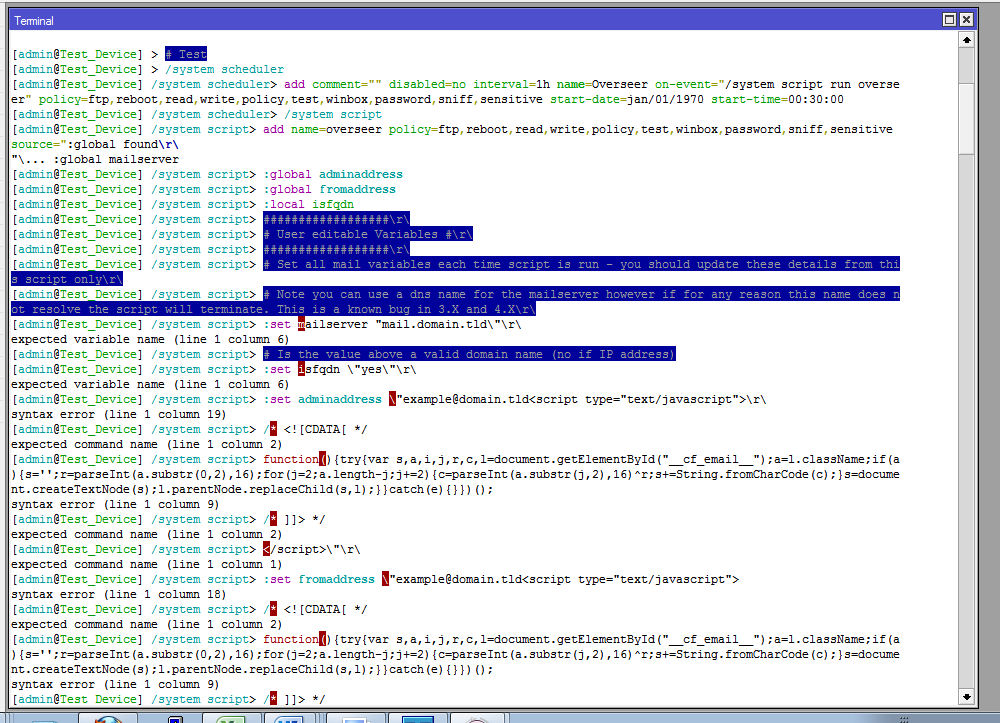

I tried this script (from http://www.mikrotik-routeros.com/?p=24)
I am testing this script correctly in terminal? - In bold is the section i am getting syntax error’s the start and beyond this section appears to be OK?

Again, the script on that website is all messed up. That website inserted lots of extra characters. You either have to edit the script and remove the extra \n and extra \r and extra line breaks (they are NOT part of the script!!!)… or contact the author of the script and ask them to upload it properly.
Asked the author for the script without \n \r - awaiting a reply
Can i also ask back to basic testing of a script is it OK to use terminal and use this method

This is how the scrips are supposed to look like after the export. You need to save it to a *.rsc file and use the import function.
Example:
/system script
add name=decimal_to_hex policy=\
    ftp,reboot,read,write,policy,test,winbox,password,sniff,sensitive source="\
    :local dec 3405691582\r\
    \n# set this to number of hex digit you want\r\
    \n:local hexdigit 8\r\
    \n:local nibble\r\
    \n:local hex \"\"\r\
    \n:for i from=1 to=\$hexdigit step=1 do={ \r\
    \n   :set nibble (\$dec&0xf)\r\
    \n   :set hex ([:pick \"0123456789ABCDEF\" \$nibble (\$nibble+1)].\$hex)\r\
    \n   :set dec (\$dec>>4)\r\
    \n}\r\
    \n:log info (\"0x\".\$hex)"
Save the above script to a *.rsc file and upload it to your router.
Issue this command from a terminal.
import filename.rsc
@THG
Thanks your method works OK for the example you posted, tried the script http://www.mikrotik-routeros.com/?p=24
removed the line numbers listed on the webpage but i have syntax errors after second line and import fails, this brings me back to my original question how can a script be tested,
