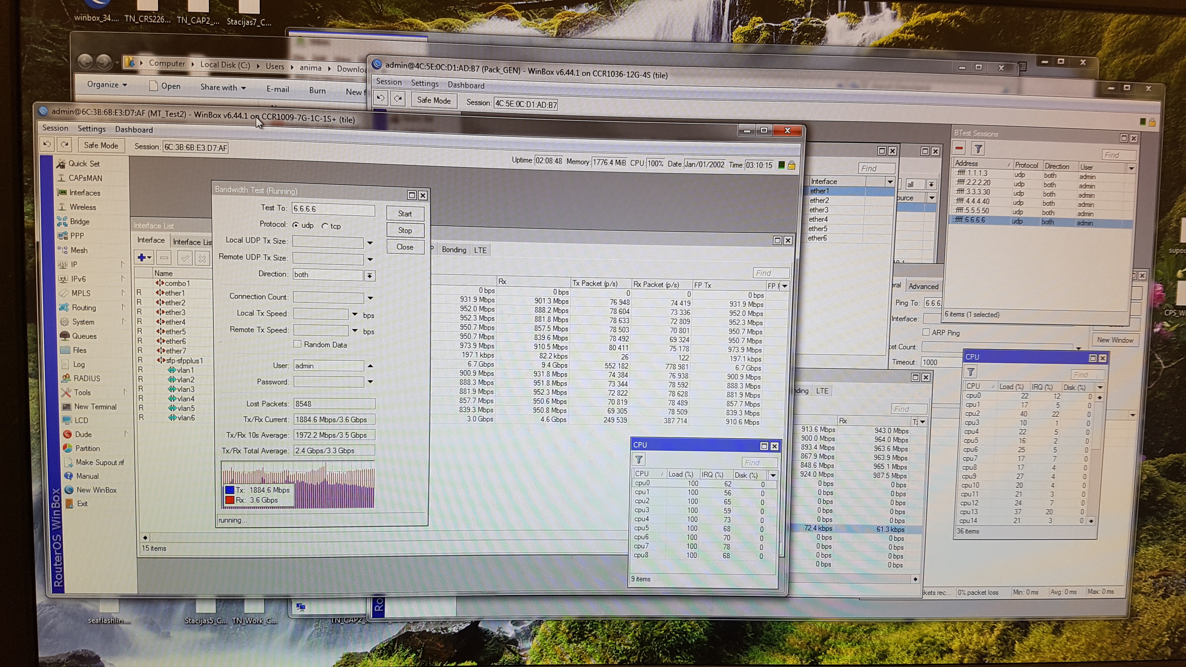

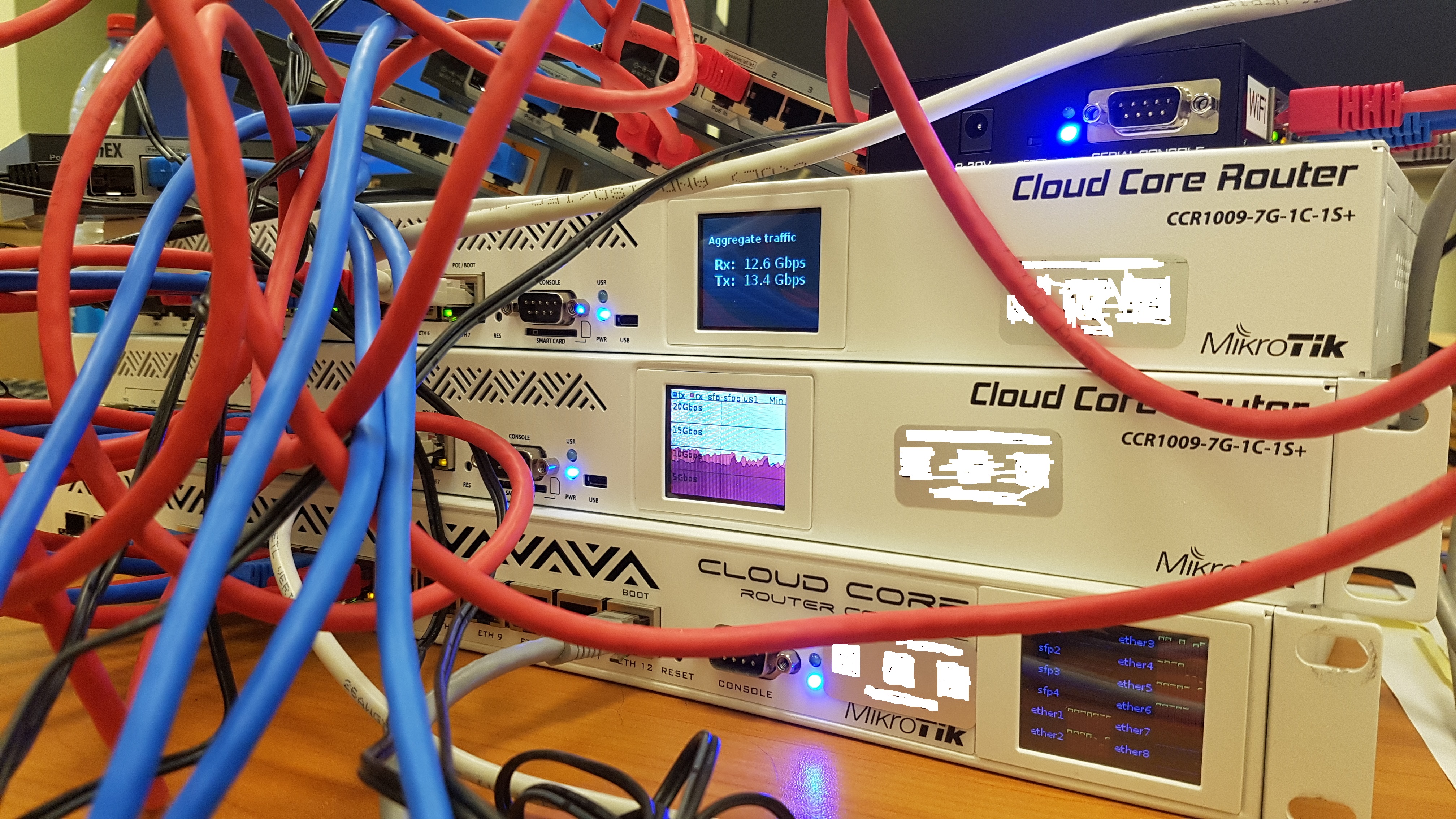

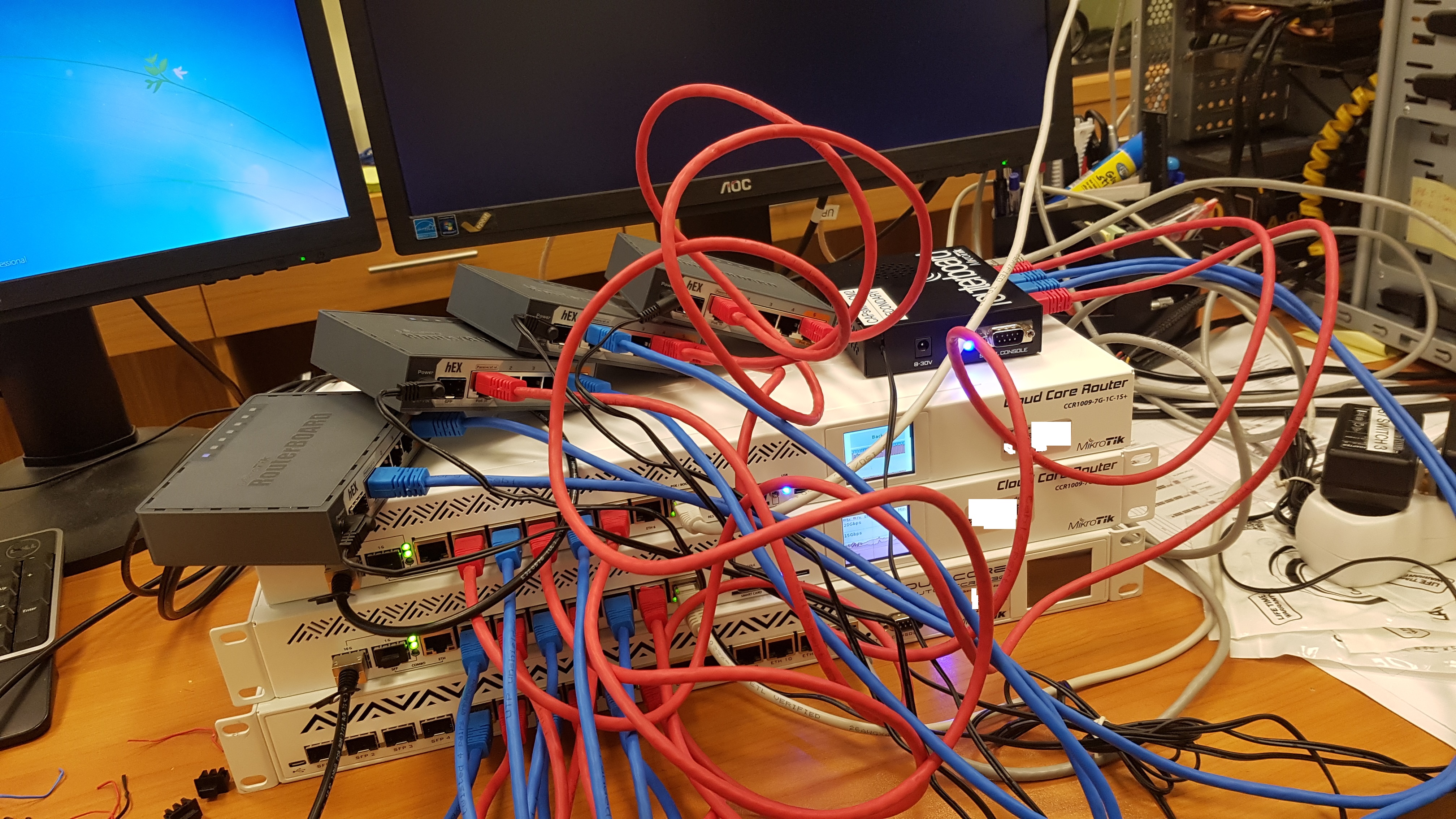

I test CCR routers very simple with simple static routing. And SFP+ use VLAN’s.
CCR’s with full 100% CPU utilization seem not really usable to have this in production under these kinds of load…nice for a lab-stress-test to max it out but…
Do you have stats on effective packet drops under these loads ?
Hard to believe it is “0” with all cores at 100% etc.

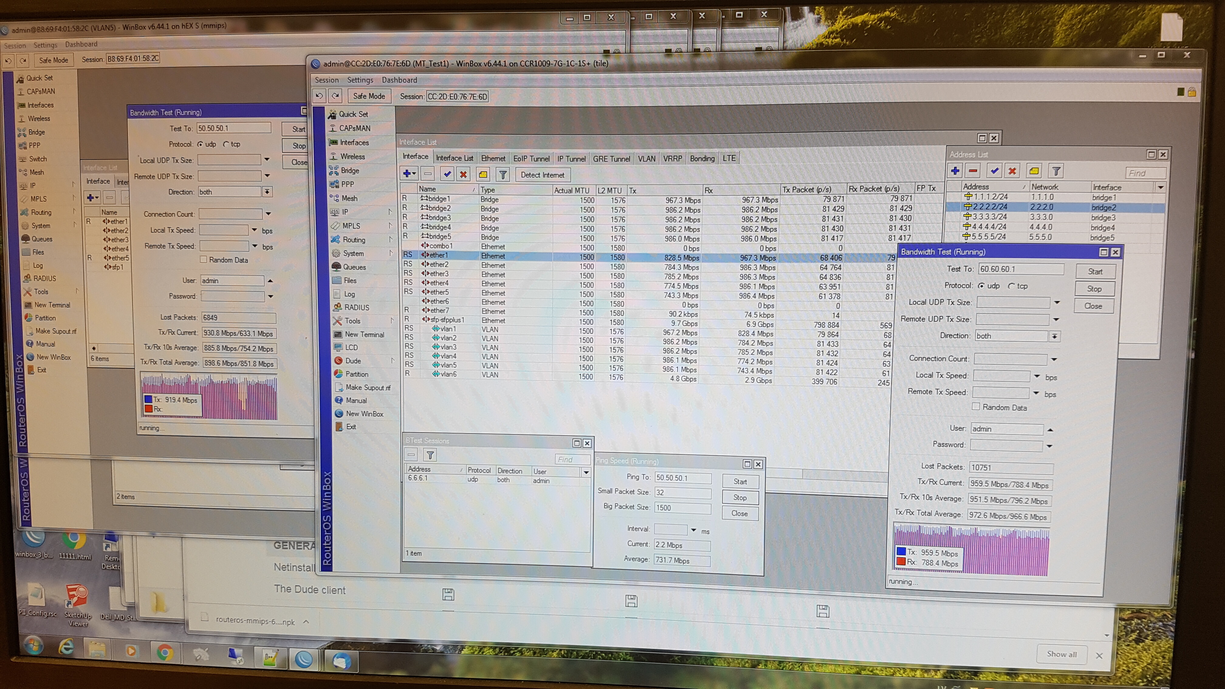

Interesting is that, when you turn on the Firewall filter drop “Invalid” rule (all MT CCR an hEX) -MT (hEX S) integrated BandWidth test produces a lot of invalid packets and traffic drop by 25%
But if this test is performed using Virtual Linux Servers (KVM VM) and the bridge interface is on SFP + so many Invalid packages VM linux server cannot be produced using SSH or NFS or Windows client connect to Linux SAMBA VM.
