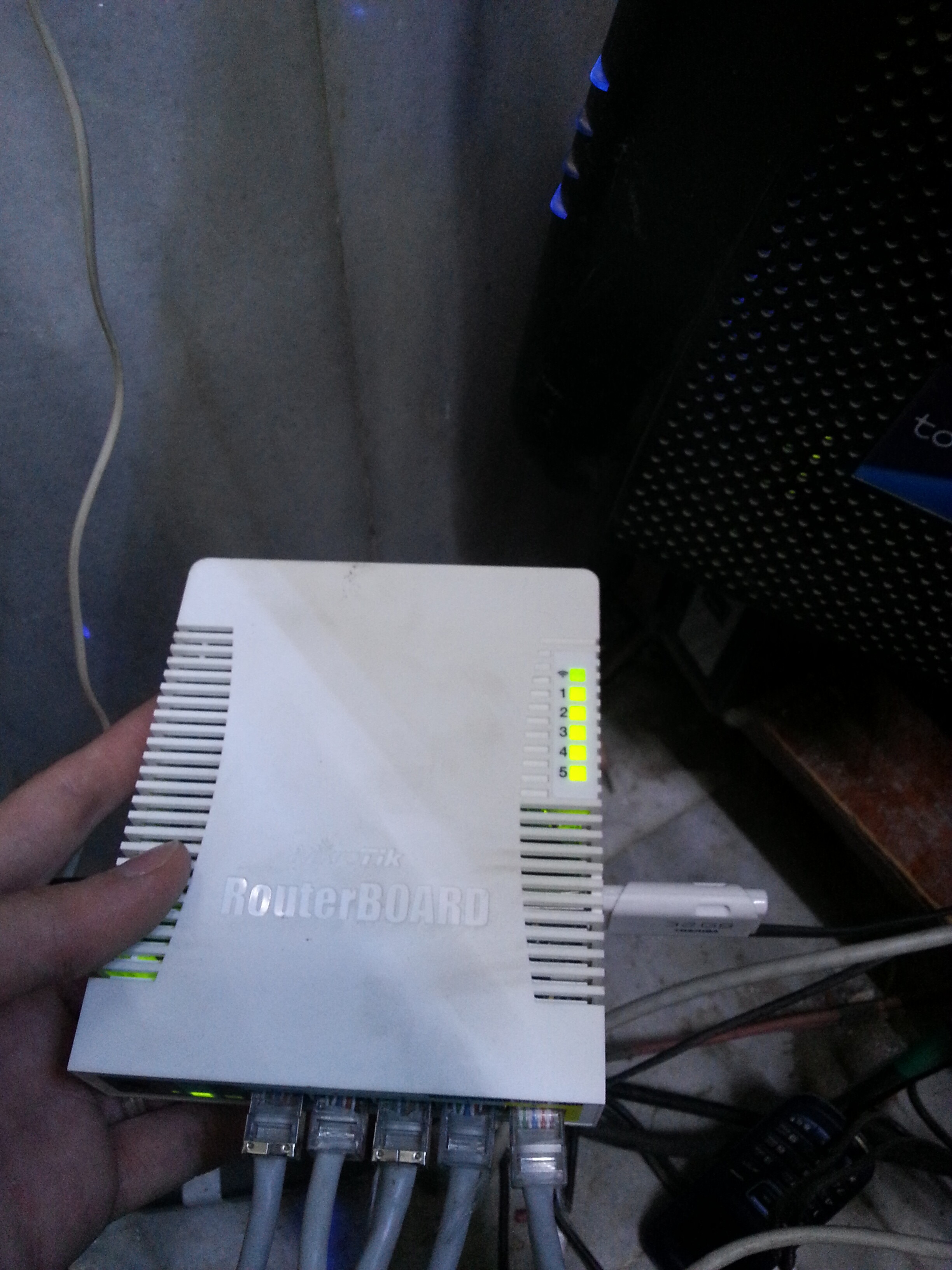

The leds doesn’t work right
here’s a video

before I used the small rb951 (without usb) and it was working fine ![]()
here’s a video
Everything is correct. If you use Switch functionality to switch all ports together, LEDs will work like this.

you mean my problem is in this configurations?
How to fix it? please?
This is not a problem, but your choice
Do you know how a switch works? It means that communication between all ports 2-5 is going directly from port to port (via switch chip) and RouterOS doesn’t control this traffic as in the case of routing. It depends on what you plan to do with the device.
