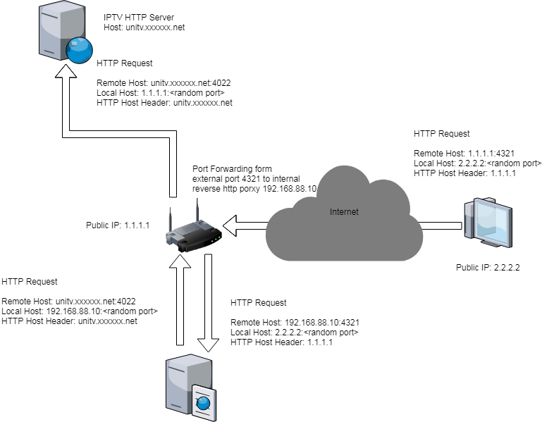

Can you briefly describe the scheme using the reverse proxy for my task?
The Cleint sends his HTTP reqeust to your router, with the worng host header. The router forwards the request to the http reverse proxy. The proxy rewrites the host header and sends a reqeust to the iptv provider.
I used nginx a couple of time as a reverse proxy. Just google “nginx reverse proxy rewrite host header”, there are lots of articles out there.
Something like that should work
server {
  listen 192.168.88.10:4321 default_server;
  location / {
    proxy_pass http://unitv.xxxxxx.net:4022/;
    proxy_set_header Host unitv.xxxxxx.net;
