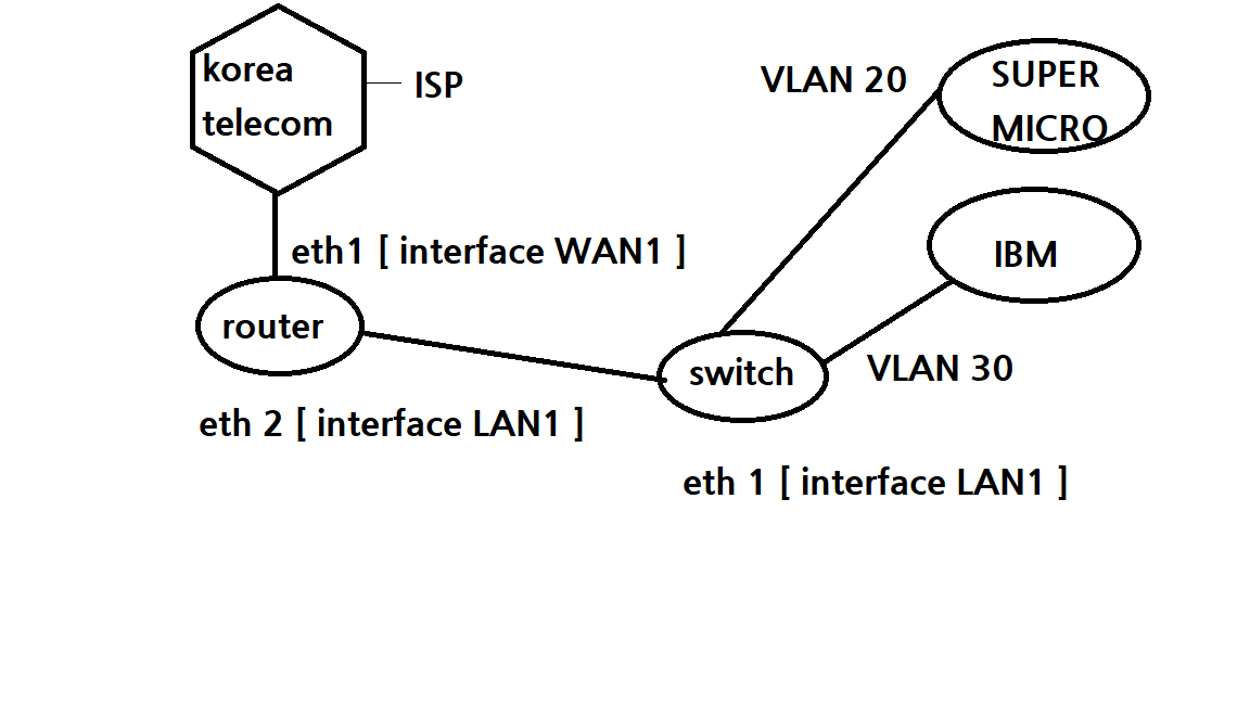

Hello, I’m asking you a question because I don’t think the VLAN settings are correct.
First of all, I’m going to let you know that we’re building an inter VLAN.
I’m Korean , And I am not fluent in English. So I have prepared a picture.
The picture will be uploaded under the name “INTERVLAN” as an attachment.
Router , switch are both running on the router OS !
Router Device = Mikrotik RB1100AH X4
Switch Device = Mikrotik CRS317-1G-16S+
Router interface [ eth 2 – LAN1 ] = Trunk port
VLAN ID 20 : 200.168.20.1/24 [ interface eth5,6 [ LAN5,6 ] ] – Switch part
VLAN ID 30 : 200.168.30.1/24 [ interface eth9,10 [ LAN9,10 ] ] – Switch part

I’ve described the problem here. Take a good look.
Problem 1
VLAN20 (200.168.20.0/24) and VLAN30 (200.168.30.0/24). But VLAN 20, 30, they exchange pings.
Problem 2,
call the following message from the switch “CRS317-1G-16S +” (Router OS update) Error message: “Cold not resolve dns name”
Problem 3.
winbox-based gateway “RB1100 AH x4” is not available (Instead, it is available via a web browser.)
I want to make an interVLAN through bridge.
I’d appreciate it if you could redefine and reply to the instructions for resolving this error.
Hi Lee,
No worries, as long as you dont have any small cameras spying on me (kpop). :slight_smile:
What you are asking to do is very possible!! Thanks for the very nice diagram!
The best reference i can provide is this link, it has very good examples for what you need.
Have a read through that and then come back to ask further questions.
Eventually you will have to post a config for us to look at
/export hide-sensitive file=yourconfigmar21
Basically the idea on the router is to create one bridge, all your vlans run on the bridge.
Do not assign DHCP to the bridge, instead assign another vlan to be your MAIN LAN call it VLAN11.
The bridge retains its default pvid=1 setting so we can leave that alone
Same on the Switch, create one bridge all the vlans created are associated on the bridge etc..
Bridge ports are used to identify any ingress rules we need (applicable for access ports, set pvid etc).
interface bridge vlan settings are for egress rules (untagging of access ports) and tagging of vlans to all required ports.
vlan 11 should be tagged to the bridges as well.
Good luck, we will see you soon.
Hello, anav
I visited the site you introduced me to the vlan setting.
Well... and then I re-painted with some changes in composition.
The picture is saved as attachment: 1111.
We have a problem.
The isp company assured me that I could never use a fixed [statc] ip.
And Only through dhcp can we assign a wan ip address.
Problem 1 : After connecting the client to LAN13 on the router and setting the client to 200.168.10.10, the internet is turned on.
But when I connect to the switch and connect to "LAN12/VLAN30 / 200.168.30.10", there is a phenomenon that is not internetable.
Problem 2 : Attempted ping 8.8.8.8.8 from switch to terminal, but the word time out is output.
Below are some of my new commands, please.
And I uploaded the setup files for the router and the switch. Please!

It appears you have two connections between the router and the switch? Is this true?
Also, please post your configs in this way…
/export hide-sensitive file=yourconfigrouter (from your router) and change your isp gateway IP and wani IP to letters
/export hide-sensitive file=yourconfigswitch (from your switch)
You can copy and paste the configs here (I use notepad++ to open the files)
Also you can use the code icon above (the one with the black square and white square brackets (to the left of the quotation marks - from the text bar where B I and U are)
Simply select highlight the code text and select that icon.
Hello, anav
I read the link you gave me, “Switch with a separate router (RoaS),” and downloaded the “RSC” file and applied the corresponding items.
Let me give you a reminder first.
VLAN 100 = MGMT-VLAN
VLAN 20 = SUPERMICRO-VLAN
VLAN 30 = IBM-VLAN
RB 1100 AH x4 = interface = > WAN1 [ ether1 ] LAN1 [ ether2 ] LAN2 [ ether3 ] LAN3 [ ether4 ] LAN4 ~ LAN12 / LAN3,LAN4 default
CRS317-1G-16S+ = interface => LAN1 ~ LAN16 , ether1 / ether1 default
RB 1100 AH x4 = > INTERFACE TRUNK = LAN1 , LAN2 , INTERFACE CLIENT [VLAN 100 ] => LAN 3 ~ LAN 12
CRS317-1G-16S+ => interface TRUNK => LAN1,LAN2 , INTERFACE VLAN 20 => LAN5,LAN6,LAN7,LAN8 ,LAN13,LAN14 INTERFACE VLAN 30 => LAN9,LAN10,LAN11,LAN12,LAN15,LAN16

errors =
Connecting clients to routers and switches does not provide Internet [ no communication ]
The router and switch are not connected, making it difficult to provide the rsc file
Below, I discuss your setup which may cause some issues and because its hard to understand your config.
First, the naming of your interfaces is very strange. There is no advantage I see to naming your etherport by LAN name and its very confusing.
Just keep them eth1, eth2, eth3 etc… If one etherport is a trunk port you could state eth2-trunk for example.
For trunk ports, I don’t think lan1 is a member (if this is your wan connection) and thus remove.
add bridge=BR1 interface=eth2
add bridge=BR1 interface=eth3
add bridge=BR1 interface=eth4
add bridge=BR1 interface=eth5
add bridge=BR1 interface=eth6
add bridge=BR1 interface=eth7
add bridge=BR1 interface=eth8
add bridge=BR1 interface=eth9
add bridge=BR1 interface=eth10
add bridge=BR1 interface=eth11
add bridge=BR1 interface=eth12
Your bridge port and interface vlan rules indicate that you have no access ports on the RB router (all connection are to devices that can tag taffic). Is this true??
Normally an etherport tagged with all vlans is what we call a TRUNK port, ie going to a managed switch for example or a WIFI device that can also tag traffic.
Normally ALL vlans do not go to ALL etherports either…
So something is not being communicated so as to understand your configuration?
For firewall rules
I would only allow the management vlan access to the router for winbox etc…,note you need to add list to that rule!!
add chain=input action=accept in-interface**-list** =MGMT comment=“Allow Base_Vlan Full Access”
For the the other vlans, only allow access for DNS services.
add chain=input action=accept in-interface-list=vlan dst-port=53 protocol=udp connection-state=new
add chain=input action=accept in-interface-list=vlan dst-port=53 protocol=tcp connection-state=new
Changing the port names so its clearer
set bridge=BR1 ingress-filtering=yes frame-types=admit-only-vlan-tagged [find interface=eth2]
set bridge=BR1 ingress-filtering=yes frame-types=admit-only-vlan-tagged [find interface=eth3]
set bridge=BR1 ingress-filtering=yes frame-types=admit-only-vlan-tagged [find interface=eth4]
set bridge=BR1 ingress-filtering=yes frame-types=admit-only-vlan-tagged [find interface=eth5]
set bridge=BR1 ingress-filtering=yes frame-types=admit-only-vlan-tagged [find interface=eth6]
set bridge=BR1 ingress-filtering=yes frame-types=admit-only-vlan-tagged [find interface=eth7]
set bridge=BR1 ingress-filtering=yes frame-types=admit-only-vlan-tagged [find interface=eth8]
set bridge=BR1 ingress-filtering=yes frame-types=admit-only-vlan-tagged [find interface=eth9]
set bridge=BR1 ingress-filtering=yes frame-types=admit-only-vlan-tagged [find interface=eth10]
set bridge=BR1 ingress-filtering=yes frame-types=admit-only-vlan-tagged [find interface=eth11]
set bridge=BR1 ingress-filtering=yes frame-types=admit-only-vlan-tagged [find interface=eth12]
BASED upon your statement here…
“RB 1100 AH x4 = > INTERFACE TRUNK = LAN1 , LAN2 , INTERFACE CLIENT [VLAN 100 ] => LAN 3 ~ LAN 12
CRS317-1G-16S+ => interface TRUNK => LAN1,LAN2 , INTERFACE VLAN 20 => LAN5,LAN6,LAN7,LAN8 ,LAN13,LAN14 INTERFACE VLAN 30 => LAN9,LAN10,LAN11,LAN12,LAN15,LAN16”
I would guess that we get rid of LAN1 (eth1 because that is your WAN connection). LAN2(eth2) is your trunk port to the switch! LAN3-12(eth3-12) are actually ALL ACCESS ports for vlan 100.
If that is the case then here is what the config would look like…
Bridge Ports
add bridge=BR1 interface=eth2 ingress-filtering=yes allow only tagged packets (trunk port to switch)
add bridge=BR1 interface=eth3 pvid=100 ingress filtering=yes only allow untagged and priority packets.
add bridge=BR1 interface=eth4 pvid=100 ingress filtering=yes only allow untagged and priority packets.
add bridge=BR1 interface=eth5 pvid=100 ingress filtering=yes only allow untagged and priority packets.
add bridge=BR1 interface=eth6 pvid=100 ingress filtering=yes only allow untagged and priority packets.
add bridge=BR1 interface=eth7 pvid=100 ingress filtering=yes only allow untagged and priority packets.
add bridge=BR1 interface=eth8 pvid=100 ingress filtering=yes only allow untagged and priority packets.
add bridge=BR1 interface=eth9 pvid=100 ingress filtering=yes only allow untagged and priority packets.
add bridge=BR1 interface=eth10 pvid=100 ingress filtering=yes only allow untagged and priority packets.
add bridge=BR1 interface=eth11 pvid=100 ingress filtering=yes only allow untagged and priority packets.
add bridge=BR1 interface=eth12 pvid=100 ingress filtering=yes only allow untagged and priority packets.
/interface bridge vlan
add bridge=BR1 tagged=BR1,eth2 vlan-ids=20
add bridge=BR1 tagged=BR1,eth2 vlan-ids=30
add bridge=BR1 tagged=BR1,eth2 untagged=eth3,eth4,eth5,eth6,eth7,eth8,eth9,eth10,eth11,eth12 vlan-ids=100
( you could shorten the first two rules to be add bridge=BR1 tagged=BR1,eth2 vlan-ids=20,30 )
Now for the switch
I am not as good with switches but will attempt to look at the logic.
I am assuming eth2 on the RB (the trunk port) is attached to eth1(LAN1) of the switch.
On the switch side, I have no issues with keeping your naming convention of LANS as switch doesn’t do routing so not confusing for me…
From your config looks like
a. LAN1(eth1) is the trunk port from the router
b. LAN5-8,13,14 are for VLAN20 (supermicro)
c. LAN9-12,15,16 are for VLAN30 (ibm)
(Missing LAN2-4?? assuming these are???
(I see that LANS 3,4 are access ports so assuming on management vlan)
(I see that LAN2 is also a trunk port?? YOu cannot have two trunk ports coming from the RB to the same switch, I believe this would be causing collisions and many issues???
Thus for the purposes of config I will treat LAN2(eth2) as another management vlan port.
Also, you are missing the untagged ports in bridge vlan interfaces…
Bridge Ports
add bridge=BR1 interface=lan1 ingress-filtering=yes allow only tagged packets (trunk port from router)
add bridge=BR1 interface=lan2 pvid=100 ingress filtering=yes only allow untagged and priority packets.
add bridge=BR1 interface=lan3 pvid=100 ingress filtering=yes only allow untagged and priority packets.
add bridge=BR1 interface=lan4 pvid=100 ingress filtering=yes only allow untagged and priority packets.
add bridge=BR1 interface=lan5 pvid=20 ingress filtering=yes only allow untagged and priority packets.
add bridge=BR1 interface=lan6 pvid=20 ingress filtering=yes only allow untagged and priority packets.
add bridge=BR1 interface=lan7 pvid=20 ingress filtering=yes only allow untagged and priority packets.
add bridge=BR1 interface=lan8 pvid=20 ingress filtering=yes only allow untagged and priority packets.
add bridge=BR1 interface=lan9 pvid=30 ingress filtering=yes only allow untagged and priority packets.
add bridge=BR1 interface=lan10 pvid=30 ingress filtering=yes only allow untagged and priority packets.
add bridge=BR1 interface=lan11 pvid=30 ingress filtering=yes only allow untagged and priority packets.
add bridge=BR1 interface=lan12 pvid=30 ingress filtering=yes only allow untagged and priority packets.
add bridge=BR1 interface=lan13 pvid=20 ingress filtering=yes only allow untagged and priority packets.
add bridge=BR1 interface=lan14 pvid=20 ingress filtering=yes only allow untagged and priority packets.
add bridge=BR1 interface=lan15 pvid=30 ingress filtering=yes only allow untagged and priority packets.
add bridge=BR1 interface=lan16 pvid=30 ingress filtering=yes only allow untagged and priority packets.
add bridge=BR1 tagged=BR1,lan1 untagged=lan5,lan6,lan7,lan8,lan13,lan14 vlan-ids=20
add bridge=BR1 tagged=BR1,lan1 untagged=lan9,lan10,lan11,lan12,lan15,lan16 vlan-ids=30
add bridge=BR1 tagged=BR1,lan1 untagged=lan2,lan3,lan4 vlan-ids=100
Hello, anav!
I reconfigured and re-ordered the equipment on the basis of what you proposed today!
I judged that I had succeeded in setting up the equipment. And I’ve written this in a separate report form!
Thank you very much. anav!
If it were not your hard work, it would not have succeeded.
A successful record!
A. Access to routers and switches is now available!
