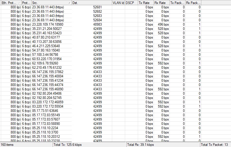

new update; once you shut the dns resolver down and remove the scripts they retaliate with what appears to be an amplified ddos attack but not? DNS resolver is not allowing remote requests and the ports used are obscure TCP ports; ie. 42499, 32386, etc, and somehow the router is transmitting huge amounts of data to these obscure Public addresses on these weird port numbers. I actually have to block the port to get it to stop. I have disallowed unestablished connections and locked them down tight but somehow the WAN interface is transmitting huge amounts of traffic 0 traffic on LAN; . All service ports are disabled, there are no files, cloud disabled, web proxy disabled, bandwidth test disabled, everything disabled and locked down tight. I cannot figure out how this is happening. I have seen this happen on 3 different routers in 3 different locations after the bitcoin miner was disabled on the router. The question is; how is this possible??? why is the router generating 1Mb of traffic and transmitting it to unknown IPs on weird ports???

Wrong question to wrong people. You are in control of router and all connections. You can track connections and figure out WHERE it really originates, you can capture packets and look into them to figure out WHAT is being transmitted.

no tx traffic bc I blocked that port number but im sure it will change; why is the mikrotik processing these packets???
