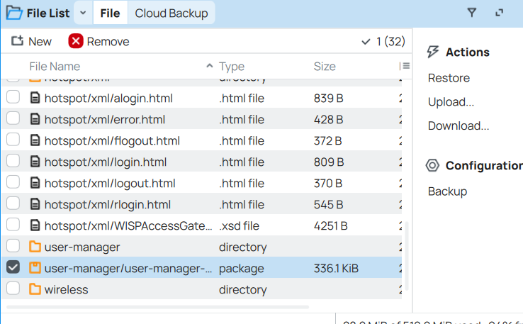

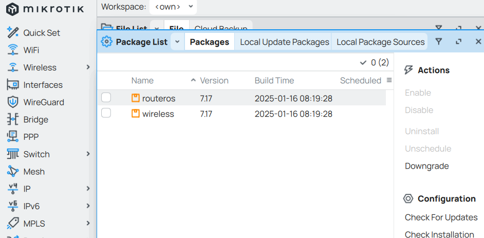

Hi, please I need help guys, is that I am trying to install the usermanager on mikrotik version 17.17, my architecture is arm so I downloaded the extra Packages ARM 17.17 stable, take the file with a long click and drop it in the Menu File of my Winbox it is copied, however, when I restart the mikrotik router when starting it I do not see it in the system-packages menu that is supposed to be as a sign of its installation, also when I try to access it through the web with userman obviously I can’t either. Does anyone have any idea what is happening?

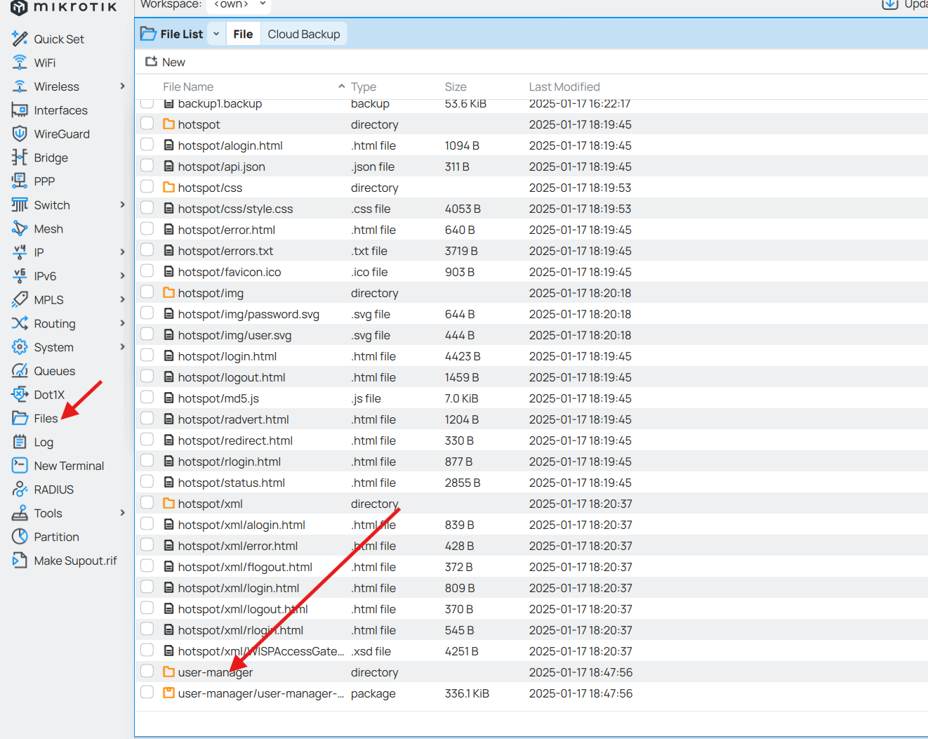

I dragged and dropped it on the white part that you say in the file menu where the other files are, the file is there but when I restart nothing happens. The version used is 17.17 and 17.16.2 does not work either, I have ARM architecture, I have enough storage. Both routerOS and usermanager have the same version 17.17.

If the file was dropped on root directory (from screen shot it looks like it is in a subfolder), after reboot you should see something in log about failed install and possible reason.
Or success.
Perhaps use the “Upload” button in Files, instead of drag-and-drop… End of the day, the package MUST be in the root folder, otherwise it will not be found after a reboot to install – at boot ONLY the root directory / is searched for *.npk files.

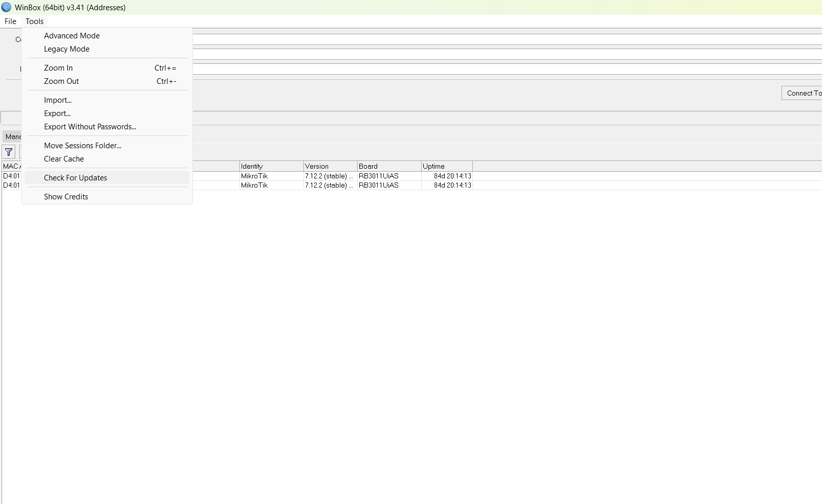

Well, it’s fixed, you’re right, the problem was that winbox, VERSION 4.0BETA doesn’t let you drag to root, it has problems, so since I have routerOS 7.17 it doesn’t let you use winbox 3.41, what I did was in that same version 3.41 I clicked on search for updates in the tool and the system installed a patch so I could use that winbox with that version of 7.17 which allowed me to drag and install the User Manager package to root just like you said. Thanks bro.
