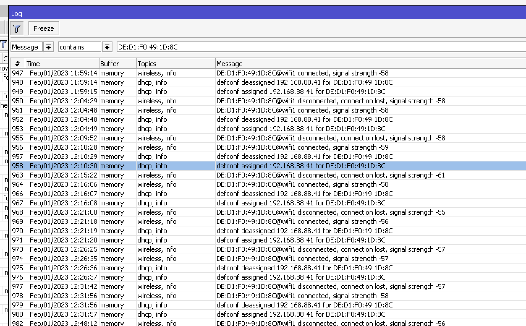

Why not use Filter button?
Thanks that would be a good option and help!

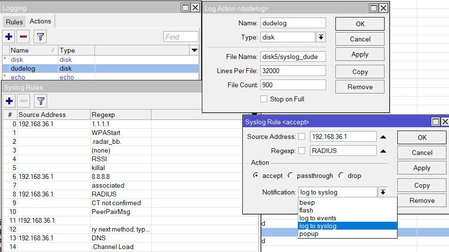

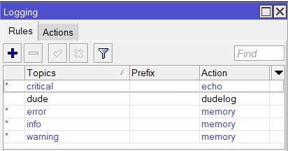

A long path … send log to ‘syslog’, with a filter
Where to find syslog? There is one in DUDE. Can be used with filters. DUDE stores result in LOG in memory. Could be stored in separate file etc.
DUDE collects all logs from all AP’s for me in one place.
dudelog action could be type email in your case.
