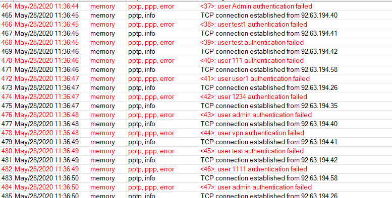

Think i'm being attacked
Hello everybody. I’m posting a photo of part of my log below. I keep getting those logs (there is no pattern like in a specific hour or something like that). The IP’s differ every time, what’s happening? is anyone attacking me? how do i stop this?
i should also say that i have an always active vpn connection to my router, although i don’t know if that has anything to do with the above logs!
This is the reason I wish MT would finally add fail2ban or their own implementation. After X amount of failed logins (you decide the service) add the IP to an address-list and you can then decide what to do with that. Someone is just trying login to your pptp VPN server (which you prob shouldn’t be using FWIW). Seems to come from the same range, just drop input from src-address=92.63.194.0/24
It has to do with your “always on” VPN in terms that your PPTP server is listening, and some bot has found that while browsing the ner and is now trying to get in to your router by guessing usernames and passwords. The owner of those IP addresses is most likely unaware of this happening because the bot is a malware which managed to squat on those devices. If the public IPs of the VPN client you use are limited to some subnet(s) known in advance, you may permit access to the PPTP TCP port (1723) only from these subnets; it will not stop the attacker from trying but he’ll not get to the authentication phase as the TCP connection will never be responded.
Other than that, the encryption used by PPTP has been considered really weak for years already. I’d suggest to at least L2TP/IPsec or, even better, to IKEv2. It won’t prevent attackers from trying to log in, but it will make it much more complex to read the VPN data sniffed between the VPN client and the VPN server.
I agree with Sindy, PPTP should not be used on the public internet.
What you can do.
  • Block the 92.63.194.0/24 net.
  • Use a script that block the ip if wrong username is used.
One of these scripts should work with just some small modification:
http://forum.mikrotik.com/t/black-list-for-failed-login-to-ipsec-vpn/130090/2
http://forum.mikrotik.com/t/can-a-script-be-created-if-a-wrong-login-name-is-used/132192/6
PS I do use some filter rules, that block the IP for 24 hours if some tries to access one port that its not open.
This way they get blocked before they find open ports and start to script attack those ports.
I think MT should remove PPTP and add wireguard LOL

/ip dhcp-server lease
add address=192.168.88.101 client-id=1:0:2a:2b:fe:44:72 mac-address=\
    xxx server=defconf
add address=192.168.88.102 client-id=1:0:e0:4c:68:0:1c mac-address=\
    xxx server=defconf
add address=192.168.88.0/24 comment=defconf gateway=192.168.88.1
set allow-remote-requests=yes
/ip dns static
    established,related,untracked
add action=accept chain=input comment="allow IPsec NAT" dst-port=4500 \
    protocol=udp
add action=accept chain=input comment="allow IKE" dst-port=500 protocol=udp
add action=accept chain=input comment="allow l2tp" dst-port=1701 protocol=udp
add action=drop chain=input comment="allow pptp" dst-port=1723 protocol=tcp
add action=drop chain=input comment="allow sstp" dst-port=443 protocol=tcp
    invalid
    in-interface-list=!LAN
    ipsec-policy=in,ipsec
    ipsec-policy=out,ipsec
    connection-state=invalid
    ipsec-policy=out,none
add action=dst-nat chain=dstnat dst-port=8999 in-interface=1wan protocol=tcp \
    to-addresses=192.168.88.101
/ip firewall service-port
set ftp disabled=yes
set tftp disabled=yes
set irc disabled=yes
set sip disabled=yes
set pptp disabled=yes
set dccp disabled=yes
/ip service
set www address=192.168.88.0/24
set ssh address=192.168.88.0/24
set www-ssl address=192.168.88.0/24
/lcd
set backlight-timeout=never default-screen=stat-slideshow flip-screen=yes \
    touch-screen=disabled
/lcd interface
set sfp1 disabled=yes
set "1wan" disabled=yes
set "3ipcamera" disabled=yes
set "4laptop" disabled=yes
set ether5 disabled=yes
set ether6 disabled=yes
set ether7 disabled=yes
set ether8 disabled=yes
set ether9 disabled=yes
set ether10 disabled=yes
/lcd interface pages
set 0 interfaces=wifi
/ppp secret
add name=xxx password=xxx profile=default-encryption service=l2tp
add name=xxx password=xxx profile=default-encryption2 service=\
    l2tp
/system clock
set time-zone-name=xxx
/system logging
add action=xxx topics=l2tp,ppp,info,account
add action=xxx topics=ups
add action=xxx topics=error
/system ups
add min-runtime=45m name=UPS offline-time=45m port=usbhid1
/tool e-mail
set address=xxx from=xxx password=xxx \
    port=xxx start-tls=yes user=xxx
/tool mac-server
/tool mac-server mac-winbox
For example, what’s the best option for ARP in the interfaces? (i have some proxy-arp and some enabled)
add action=masquerade chain=srcnat comment=“defconf: masquerade”
What is this for… ???
/ip service
Hello friend. If you refer to:
/ip service
then it’s for browsing via my vpn. I have specified the subnet that i want to browse so as the rest cannot.
