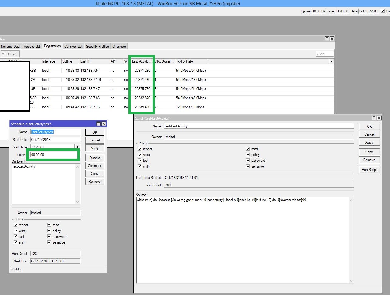

this script not working when wireless freezing -HELP-
while (true) do={:local a [/in wi reg get number=0 last-activity]; :local b {[:pick $a +4]}; :if (b>=2) do={[/system reboot];};}
The “on-event” value should be the script source itself, not a script name.
Your script is causing a never ending while loop that causes the Metal's CPU to peg out at 100%. And then five minutes later it does the same thing, adding another one. Get rid of the loop for starters. And when comparing times, you can do something like this (2s being "2 seconds", and decimals are acceptable 1.5s, 2.2s, etc):

not a specific client All ; the problem it’s the wireless in some time between 3 hours and 3 days stop transmit the packet it’s like “freezing”;when last activity numbers count a big number that mean the wireless it’s down and it’s necessary to reboot the RB-metal

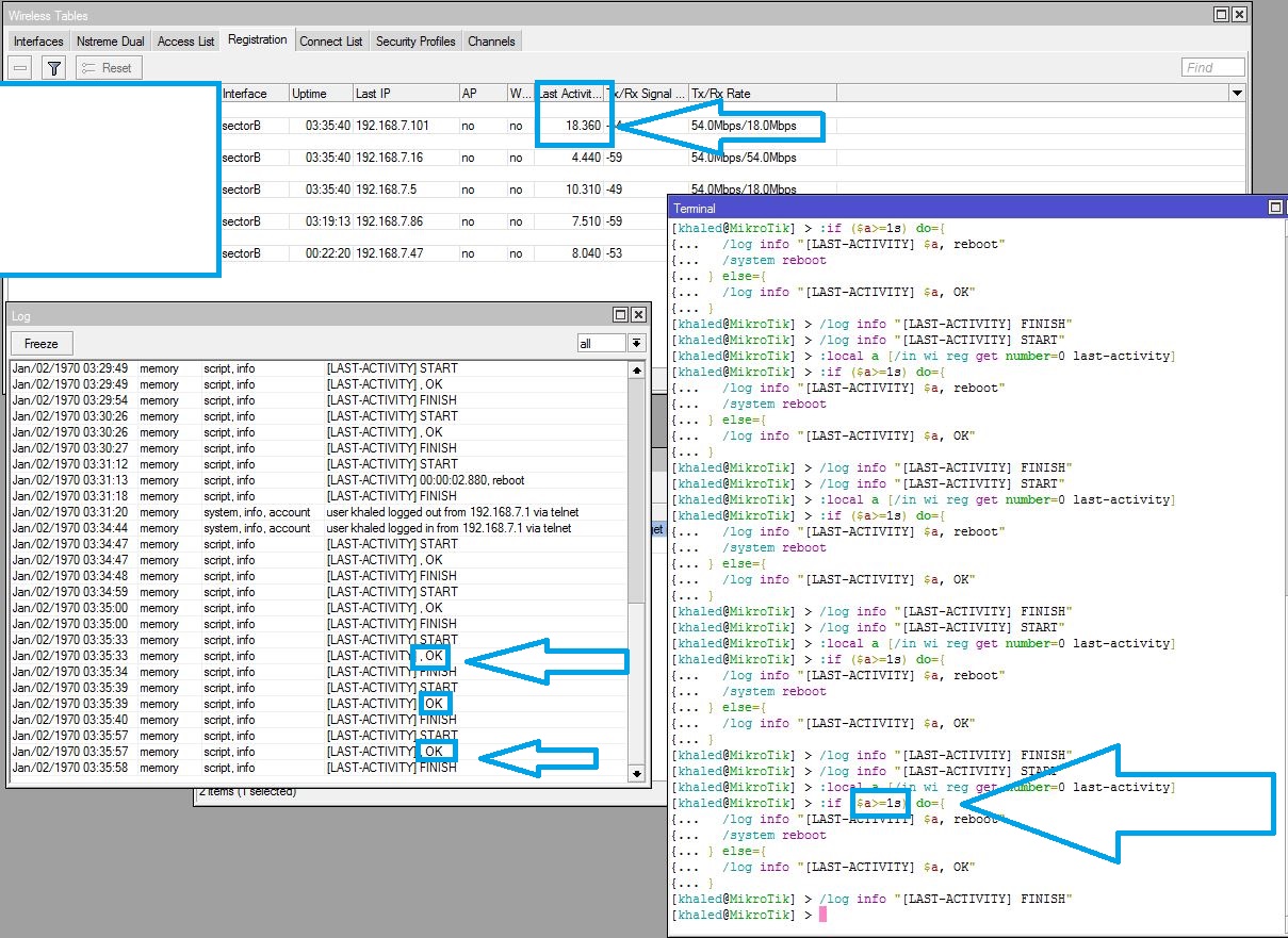

i am using your second script “the testing script” and i am changing the necessary.
The proof :slight_smile:
the result:
00:00:10.870
This is the last script "your test script

i am testing this script manual several times by change the argument 1s 2s like real last-activity and the router reboot evry time if last activity correspondent the “if”

i try your script and the result all time “ok” on “1s” argument , i will try when the problem appears {the problem the last activity count numbers : 100 and more.
In your example, all the OK lines should have the time value just like the reboot entry.

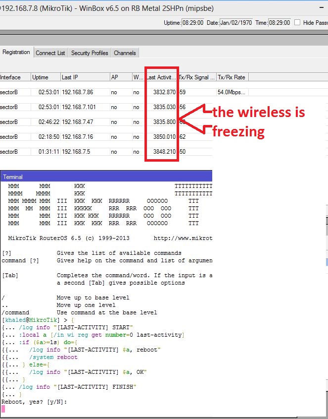

new problem: the script not working in scheduler when the wireless down “freeze”
but i try to paste the last code in new terminal And the result Ask to reboot the router -i try 1s and 70s -

In the terminal, this is normal behavior, it will ask if you want to reboot. In a script, it will reboot without the prompt.
When the wireless is freezing, what do the logs say? Does it indicate the scheduler/script is running?
