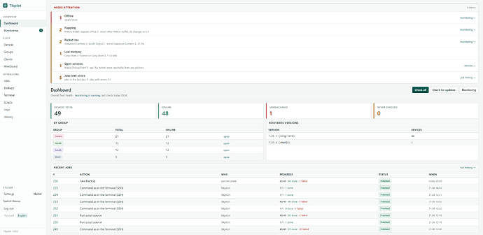

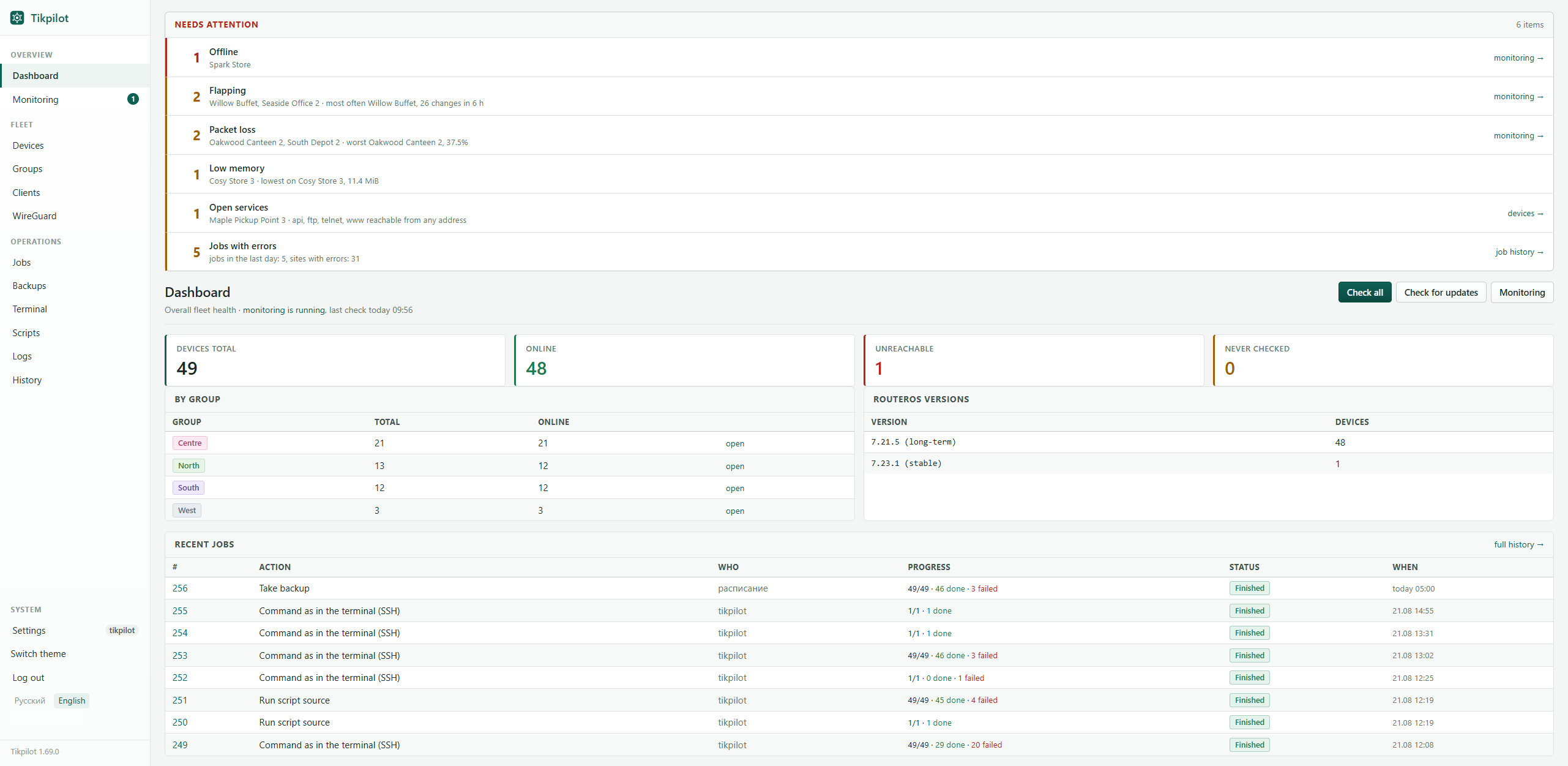

  • Needs attention: one list at the top of the dashboard instead of six
    pages - offline and flapping sites, packet loss, stale backups, syslog
    that stopped arriving, armed rollbacks, failed jobs, CPU and memory
    pressure, services open to any address, available updates. When
    everything is calm the block is not there.

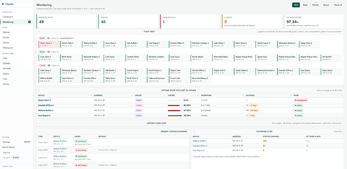

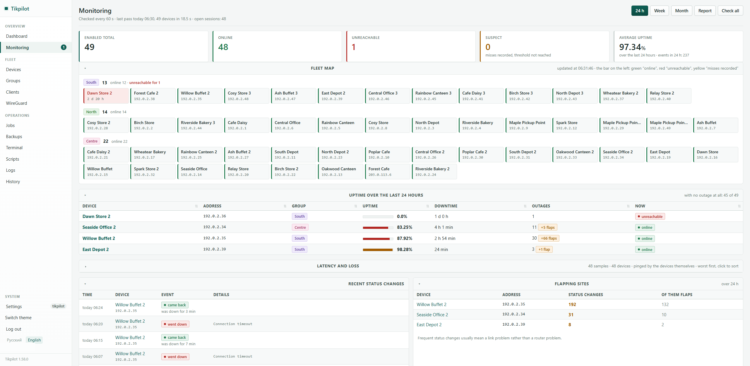

  • Availability monitoring: a site counts as up when it answers, over
    the API or over ICMP. If only ICMP answers it stays up and gets a "no
    API" marker, because a broken tunnel is not a dead shop. Uptime per
    site, latency and packet loss measured from the router itself, a fleet
    map and reports by group, device and date range.

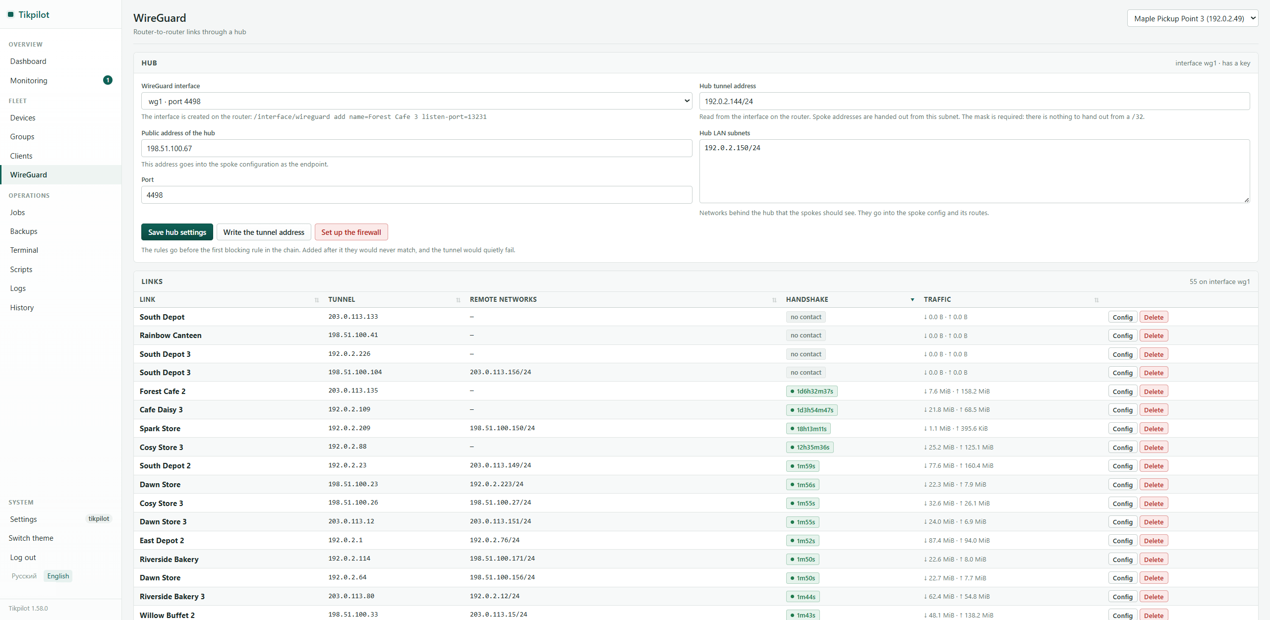

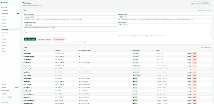

  • WireGuard: router-to-router links through a hub, with handshakes,
    traffic and routes. The spoke config is generated for you.

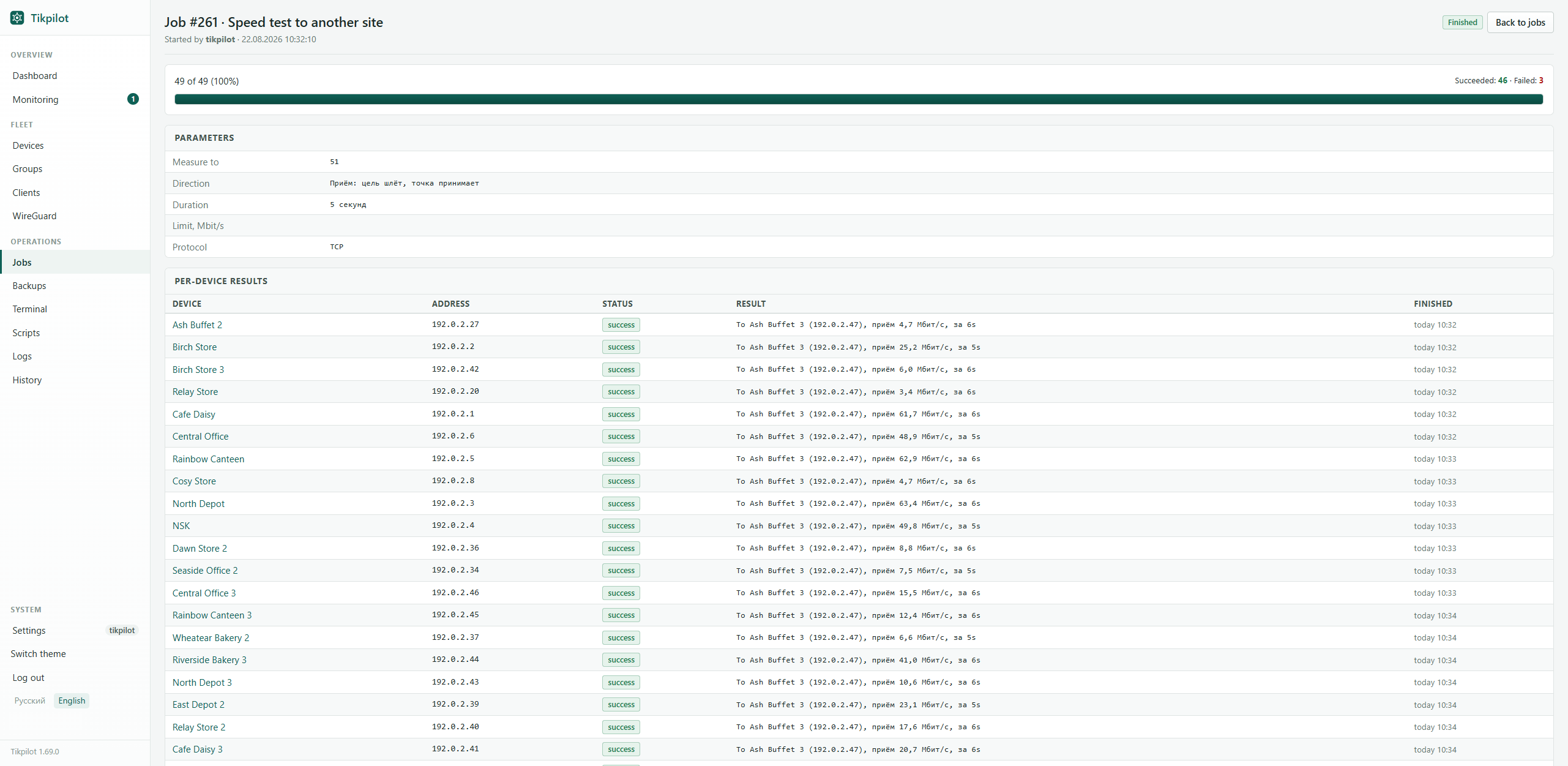

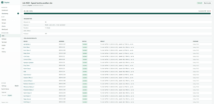

A fleet-wide speed test, one line per site, measured by the routers
themselves rather than from the server:
ВСТАВИТЬ КАРТИНКУ: speedtest.png

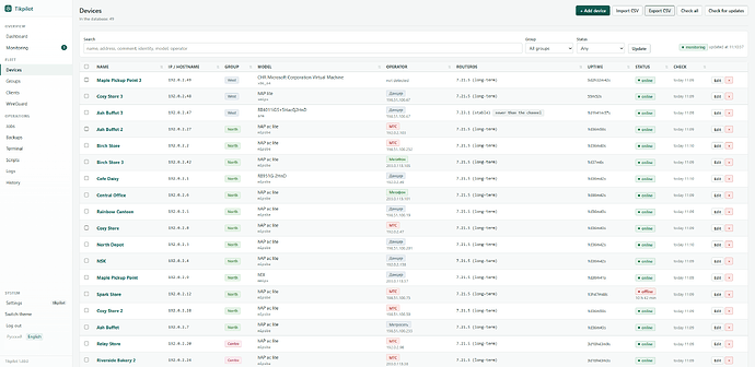

Then open the panel, add devices by hand or import a CSV, and create an
API user on the routers. It talks to RouterOS over the API (8728/8729)
and over SSH for the terminal.

A site being unreachable and our API being unreachable are not the same
thing.
Sites kept sitting in the panel as offline while WinBox opened
them fine. The panel was not lying, it really could not connect on 8728,
but it was answering a question nobody asked. What the person looking at
the dashboard wants to know first is whether the shop is alive; whether
the panel can manage it is the second question.
So the status is now reachability first: online means the router answers,
a ping being enough. If ICMP answers and the API does not, the site stays
online and gets a "no API" marker instead - a link, a tunnel or the
service on the router, and nobody has to drive out. Offline means both are
silent. Downtime and availability percentages follow the same rule, which
also stopped the 30-minute unreachable rule from waking me up over a
choked link.
Only devices that failed over the API get pinged, so on a normal day that
is nobody. It goes through the system ping with no root, and if there is
no ping in the container the API decides alone, as before.

Needs attention. The panel was good at "how are things" and bad at
"what should I deal with". The second answer was spread over six pages, so
now there is one list at the top of the dashboard: offline and flapping
sites, packet loss measured by the routers themselves, backups older than
a week, syslog that used to arrive and stopped, armed rollbacks, jobs with
errors, CPU and memory pressure, the panel's own disk filling up, services
open to any address, available RouterOS updates. Nothing extra is polled
for it - every check runs over data that was already collected. When
everything is calm the block is not rendered at all.
Speed test between two of your own sites. The panel has credentials
for both ends, so it enables the btest server on the target, supplies the
target's own login, runs /tool/bandwidth-test from the source site and
switches the server back off afterwards, including when the test failed.
Direction, duration, protocol and a cap are configurable.
The first fleet-wide run taught me the thing I mentioned above: twelve
sites measuring towards one target at the same time split that target's
channel between them, and I got twelve understated numbers that each
looked like a measurement. Measuring actions now go one site at a time.
