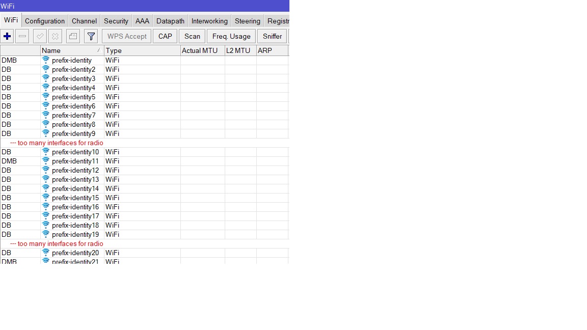

Hi, I have CAPsMAN configured on a CCR2004 with ROS version 7.15.3. In it there are 17 cAPs AX and 6 mANTBOX AX 15s. In WIFI tab (image attached) I see the message “Too many interfaces for radio” Anybody know what that means?. Thanks in advanced.

too many slave configurations. like the error message told you.
