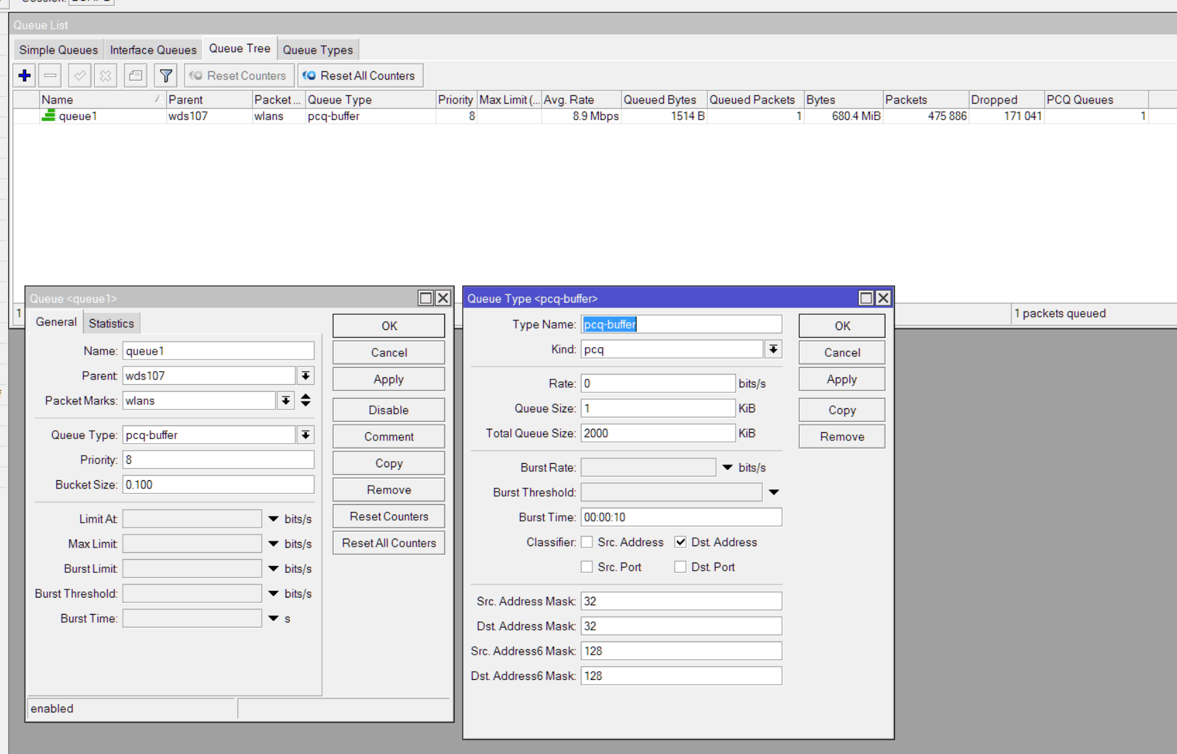

/queue tree add name=wifi-buffer-check packet-mark=wlans queue=pcq-buffer parent=wlan1 (or wds1/2/3/n...)
Then, we run SpeedTest from client device (preferably UDP) to cause buffer overflow of wireless interface.
Tracking parameter of dropped packets in Queue Tree. All traffic that could not be sent over Wi-Fi in time will accumulate in buffer of wireless interface driver, and then in buffer of PCQ queue (1 KB).
When PCQ queue is full, packet dropping will begin. Using this parameter, you can take statistics and understand when packets are delayed in buffer for too long (radio interference, bad signal, re-reflections, etc.).

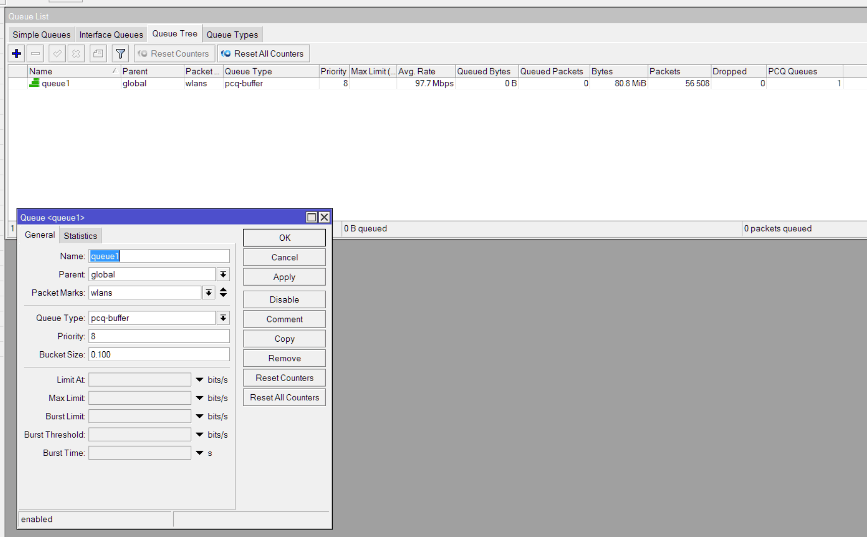

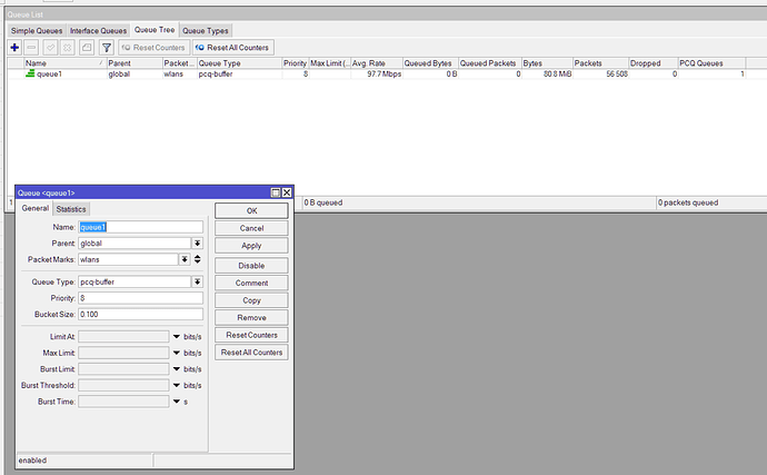

This works when using parent of some interface (wlan1 or wds1/2/3/n...). The problem starts if you use dynamic creation of WDS interfaces.
In this case, only thing you can use as a parent is Global. But when using Global, you will not have packet drops and you will not be able to track buffer overflow.
The only way out of this problem is to use interface-list with include of dynamic interfaces. But we can't use interface-list in Queue Tree.

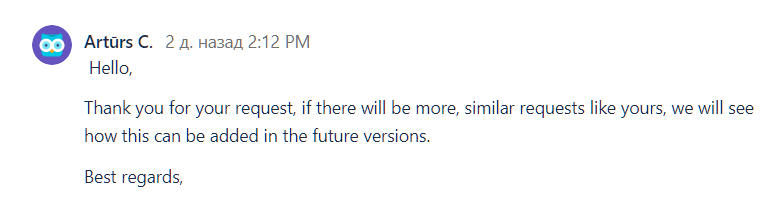

MikroTik support confirms this possibility, but will not add it until there are more similar requests.
Check out this feature for yourself and if you find it useful, create a future request in support.
