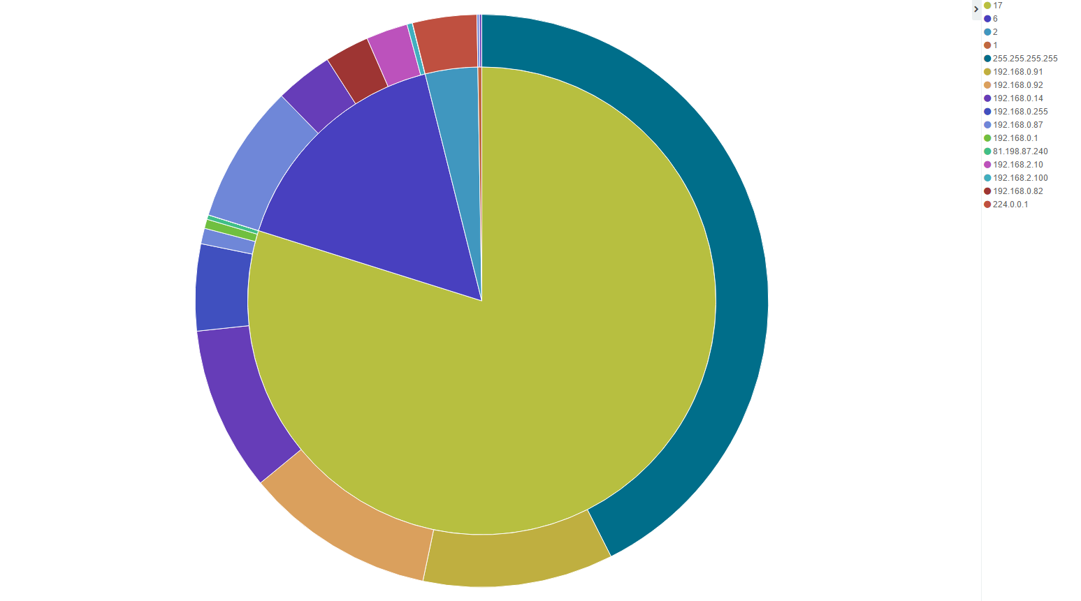

I’m trying to use traffic flow to monitor the network traffic using the ELK stack.However it seems like the switch is only providing Broadcast data or data that goes to or originates from the switch itself. So if I have any traffic going from one computer not connected to the switch to one that it or vice versa , it never shows up, no matter what form of traffic it is. Here’s an example screenshot from what the switch is reporting
This is in a 1 week time frame.
The inner circle is the protocol used and the outer circle is the IPs that are used for that protocol.
As you can see above over 3/4 of the traffic I see are either broadcasts or communication from the switch to the servers that it’s sending the traffic flow data to.
