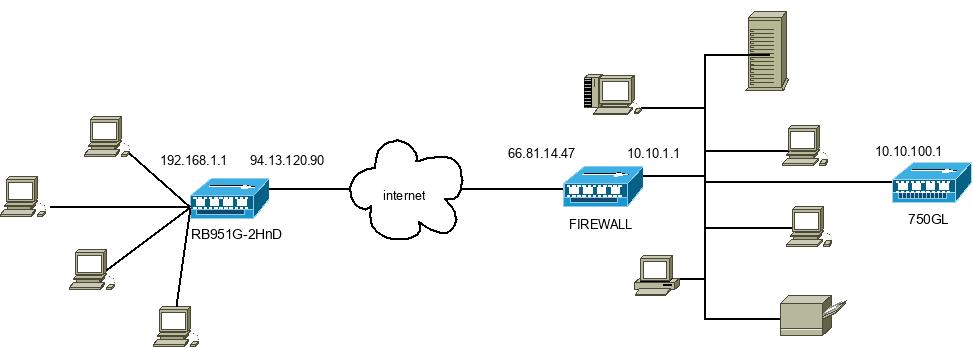

I want to explain as a the network is arranged.
Perhaps a problem in this.
Sorry for my English
