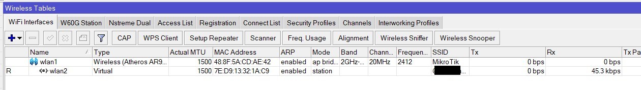

when i boot the device at home. it connect to the wifi and i can connect to its wifi.
however this weekend i was in an hotel and put it to the test.
power up the device… and that is all there was happening.
I think (but was not able to confirm) the the router is waiting for the upstram wifi to choose the right wifi channel before it starts sending it own wifi.
so the question is. do i have the right device (and simply don’t understand how to configure it)

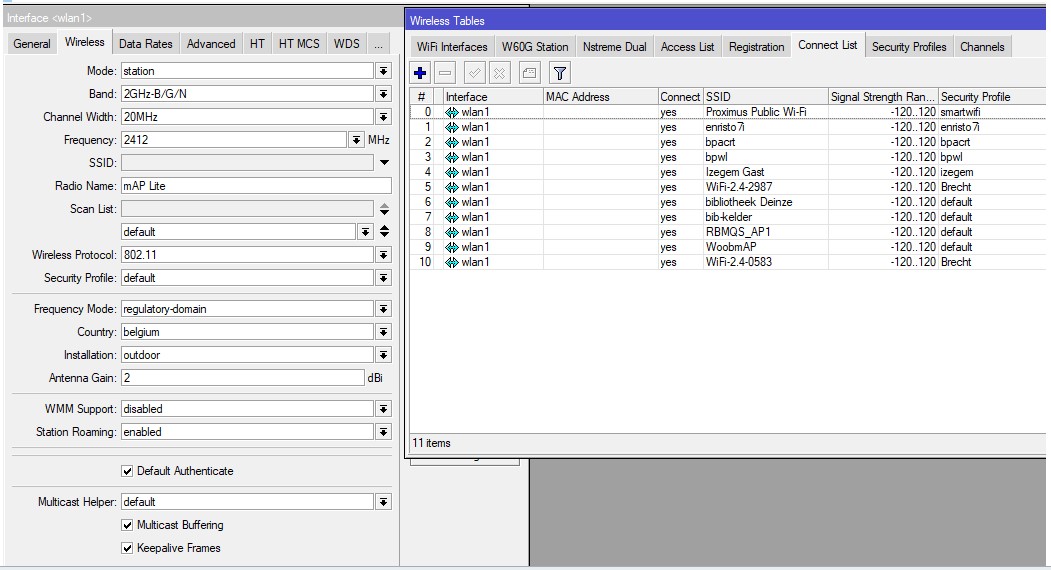

I use this very often. Had the same problem, and hated the “config reset” workaround to get in wirelessly to set the host SSID & security.
With the “connect list” with all your known SSID’s that you ever use or used its 100% automatic. Just in case of a new situation one of those used SSID’s (BPWL) is my own smartphone hotspot.
No need to carry an ethernet cable or have a client device with an ethernet port. It automatically selects the right SSID, even @home.
It also connects to my Woobm or my RBMQS.
Once connected to any SSID in the list, you can get in via wireless, and edit the connect list if needed.
http://forum.mikrotik.com/t/auto-connect-to-different-ssids/141473/1

The connectionlist is a great part. this means i can add the “most used” networks to the list.
the part with the hotspot is better then nothing. however not perfect.
This means i need to set my phone to an hotspot, get my wifes phone and connect to the “lan” wifi. to change the configuration.
otherwise we need to allow configuration from the wan interface…from an untrusted network. (wich is disabled by default)
for the connection list, is it possible to re-order them?
and when i add a profile without an ssid and security to none. will it connect to any network without encryption?

I have my 7" tablet and my smartphone. The laptop would be no problem as this one has ethernet. But I travel light.
Even opening the WAN WLAN interface will not help. The WLAN stays down until connected, once any AP is connected both are open.
You could swap the functions AP-bridge and station-bridge between the physical and the virtual WLAN interface. But then only AP’s at the same frequency are connectable.
The connection list can be sorted by dragging the items in Winbox. Something similar must be there in Webfig, but I use Winbox or the Mikrotik APP in Android.
Never tried “without SSID” what that one does. In the log with /system/logging set with Topics=wireless it gives the impression it could work. Interesting thought.

Go to connection list. add a new entry without an SSID. (for the open networks)
And here i can drag and drop to reorder (sometimes the solution is so simple that you don’t see it)

I tried to configure a travel router and in default config (no default configuration), the salve connects without the master running:
In this setup I can connect via my phone to the wlan1 (ap bridge) interface and configure the wlan2 (station) interface to connect to the Hotel-WiFi. Even if a captive-portal is in place. Simply connect once via your phone, accept the conditions, connect via wlan1 to your router and change the MAC of wlan2 to the MAC of your phone. This way the captive-portal will “think” your wlan2-interface is your phone.
The only “limitation” is, you have to do once a Background-Scan and set the frequency/width (of the wlan1-interface) to the values of the SSID you want to connect to (via wlan2). Because wlan2 will use the same frequency/width as the master. If you want to connect via wlan2 to the Hotel-WiFi, you have to change the frequency/width in the master (wlan1) interface.
Tested with ROS 6.49.7 and ROS7.8.
Yes this should work this way.
Master is AP or AP-bridge.
Slave is station or station-pseudobridge (there are 2 scenario’s here!) Station, with masquerade or SRC-NAT is expected to be the most stable, and will allow the master interface with AP to have it’s own DHCP server and range. Everything sent to the hotel AP, has the WLAN2 interface as source. So if any device does the captive portal interaction, eg via WLAN1, the captive portal will only see the WLAN2 IP and MAC address, independent how many other devices are connected to WLAN1, all will be seen as just one device.
Only reason to change the MAC address of WLAN2 , that I see, is when the hotel would block MAC-address-recognised routers.
(Like campings that block known repeaters (EnGenius ENH200) because of too many abuses (account sharing and illegal TX power)
Trick is indeed is to set the correct frequency in WLAN1 (master), for WLAN2 to work on the hotel frequency.
PS: My setup with WLAN1 as station, and a long connect list with all my known hotel SSID works automatically. But for a new localion this setup here is indeed easier.
