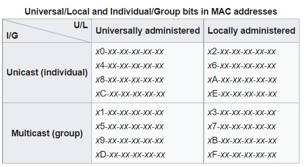

In my setups, I see 2 groups of MAC addresses for VAP’s. The first group is derived from the master WLAN and incremented. The second group starts with 02:00:00 (locally administered MAC address ???)
Those “locally administered MAC addresses” for WLAN did not work in one specific ROS release, they were on the “even” WLAN numbers. (Can’t find it back, years ago).
So just wondering if this might interfere or not.
EDIT: found it back … was ROS7.0beta8, not directly related, just gut feeling
http://forum.mikrotik.com/t/v7-0beta8-development-is-released/140169/1
Hi bpwl, anything is possible as I think my config is as good as it can get!
In my case…
Mac of AP C2:AF:44:48:B5:C4
Mac of parent WLAN C2:AF:44:48:B5:C6
Mac of virtual WLAN C4:AF:44:48:C7
Adjusted to protect the innocent but the colorations show the relative change from the AP itself.
Adjusted C2:AF to C4:AF ??? :confused: Or was it C4:AF to C6:AF what I expected.
https://en.wikipedia.org/wiki/MAC_address
The representation of the numbers is not accurate to what I actually have on the devices.
What I did represent was the relative difference from the AP itself to the two WLANs.
Dont get hung up on the actual numbers.
The top unicast chart applies, all looks good, no weird numbers sorry for the confusion.
