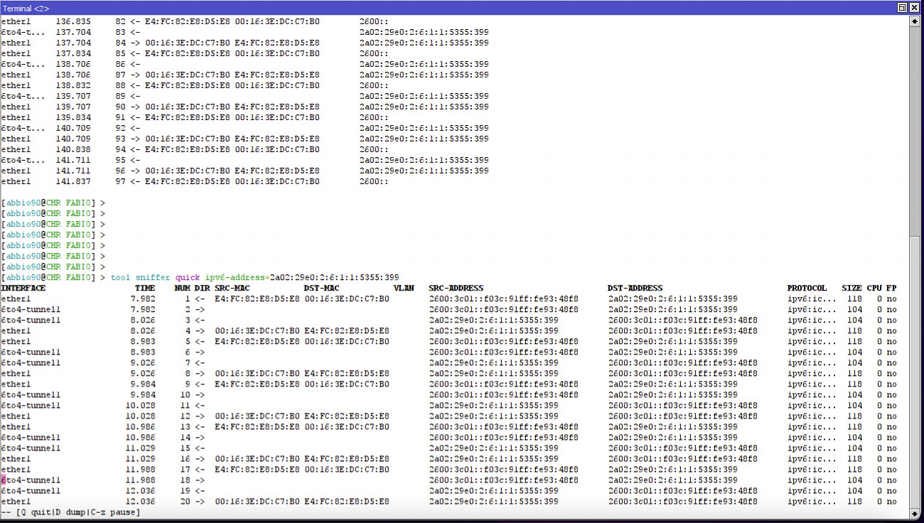

from the sniffer I would tell you that the ip from ether1 arrives at the chr and it is even encapsulated in the tunnel … but in the RB if I smell I don’t see anything
That sounds weird to me. So you can see the ping request at two interfaces, coming in via ether1 and leaving via the 6to4 one, at CHR1, but you cannot see it at the RB at all?

yes, but looking carefully at the photo, I do not understand if then from the tunnel it succeeds towards ether1 .. I imagine that being bidirectional is normal ..
The sniffer output shows that the remote RB even responds to the ping - the arrows show the request came in via ether1, got forwarded out from 6to4-tunnel1, then 44 ms later the response came in via 6to4-tunnel1, and got sent out from ether1.
Did the responses reach the machine from which you were pinging?
